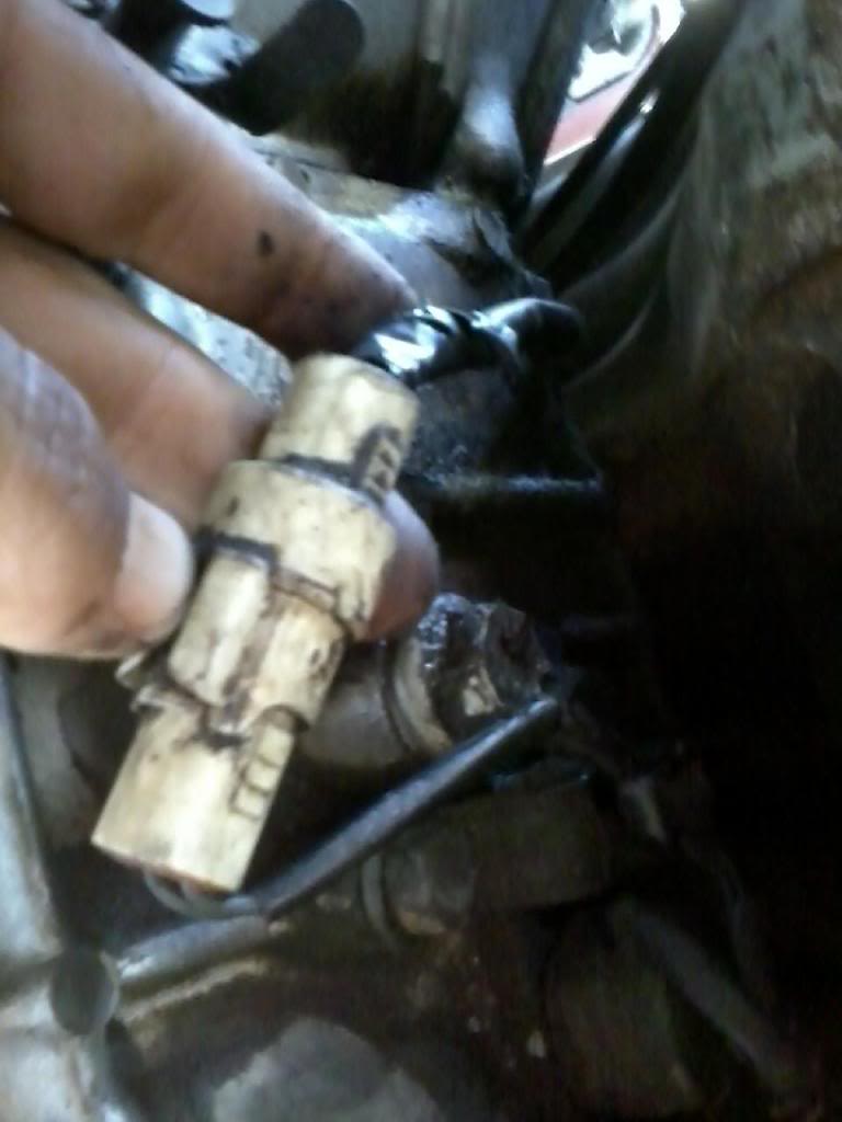

Electrical could be several problems. I am going by what I have seen a few times in the past. With your gauges not working, it sounds as if the Engine fuse is blown. The Reverse light plug if not mounted correctly can rub the insulation off and short causng the fuse to blow. It does not take much at all to expose the wire. The three times I have seen it, it was at the top of the connector. When you pull the connector out of its holder, the sleeve may slip down and cover the bare wire. Slide it back up and see if there is a bare spot.
It is located on the drivers side. It is just a guess but a freebie check. Could be a poor design by Toyota. I have removed hundreds of butthead connectors. I suggest solder, heat shrink, and then wrap with electrical tape.

I like that Butt head connectors
If the wiring has been modified in a not good way no telling just what problems the O P is dealing with.

Thanks for the info so far guys I had the alternator checked out today it checked good. Both lights still stay on I've checked for grounds I haven't found anything yet. I'll have to check the reverse light plug tomorrow its getting chilly outside right now.

Originally Posted by Terrys87
...With your gauges not working, it sounds as if the Engine fuse is blown. The Reverse light plug if not mounted correctly can rub the insulation off and short causng the fuse to blow.
Yes, looks like this.
