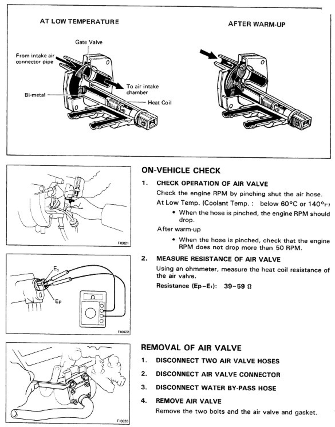

If it is an EFI I'd think the Idle Air Control Valve is fubar.

I tested the valve at cold and warm and matched the RPM drop expectations. I had to use pliers to pinch the tube because it was so stiff that I couldnt do it with my fingers so dont know if thats an indication of anything. Also, I did not measure the resistance because I didnt want to take it apart assuming it was fine based on the cold/warm tests.
I think you are on to something as I mentioned before this only happens when the engine is warm.
