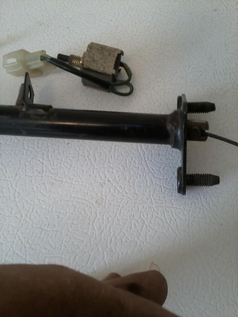

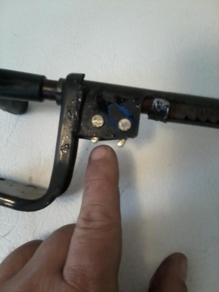

I am a cheapscape and get mine from the salvage. I remove the brake sensor using a 12mm wrench and that will let the lever slide far enough to get the slug out of the ebrake shaft. It usually breaks near the firewall from my experince. Then I push the two tabs to the firewall and that will let the shaft slide just far enough to remove the old slug and install a new cable.
Sensor removed to allow the lever to slide far enough to get broke cable out and new cable in.
You will need to push both tabs at the same time toward firewall to let whole handle/shaft to slide far enough out for the slug on end of cable to be exposed like picture above.

I would not call you cheap, I would call you smart, plus you get more parts for your money in the long run, if you find one worth buying in a yard. Maybe that's the way to go here. Thanks for the info and pics, that will help. New is not always better
