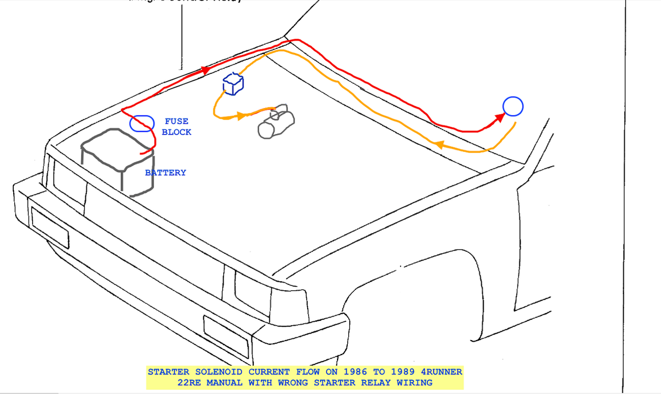

I am pretty sure that your starter relay was wired wrong AT THE FACTORY, so the current to starter solenoid has to travel an unnecessarily long path...
However, before you tear into your wiring, pls check if this CONSISTENTLY makes your starter solenoid (piggybacked on the starter motor) clunk ENERGETICALLY when you apply 12V directly from battery to its control pin as shown on my post here (https://www.yotatech.com/forums/f199...l#post52367443), then report back.
