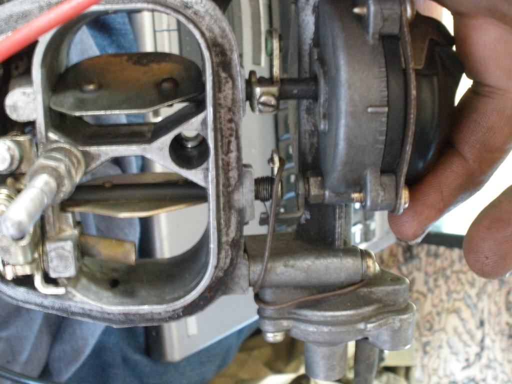

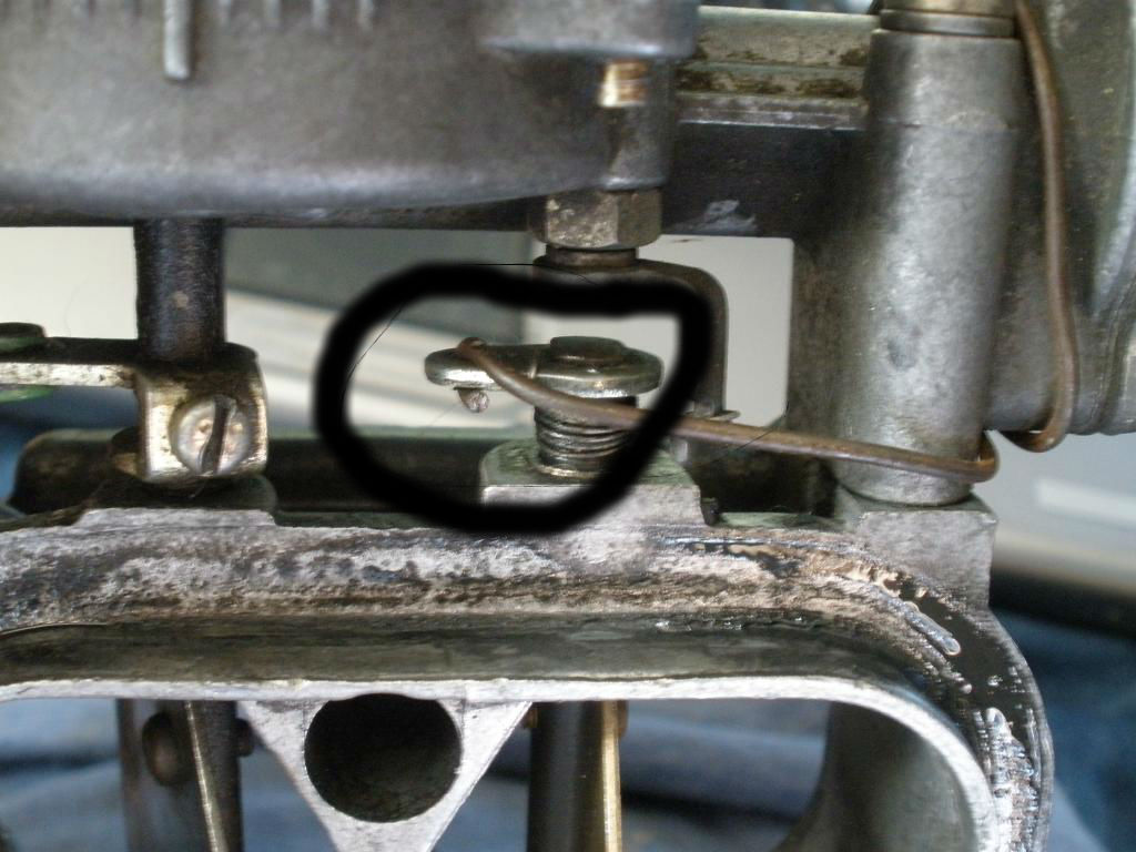

I am missing the external linkage that travels down into the linkage assembly on the side...
The air valve is connected to the fuel metering rod.
The linkage arm that connects here (Circled)

You can see it better, here:

OK, I see. Remove that wire holding open the Air valve.
The Air Valve is design to open automatically open under pressure differential when the secondary throttle valve opens. The Air Valve will rotate independently of the rod linkage that is missing.
When the secondary throttle valve is closed, the linkage holds the Air valve partially open. When the secondary throttle valve opens, the linkage will allow the Air Valve to fully close. Then vacuum (negative pressure) is formed under that Air Valve from engine vacuum. The higher atmospheric pressure (above the Air valve) will force open the Air Valve. The greater the vacuum under the Air valve (how much the secondary throttle valve is opened), the greater the Air Valve will open.
Because the secondary barrel has no venturi, Aisan designed this Air Valve system to operate as a variable venturi. Not a true variable venturi but something like a hybrid.
You should still scavenge these two linkages from the junkyard, if possible, to fix your carburetor.

The only thing I would say is that the power made by the secondary throttle may either come late or may be poor because there is not enough vacuum created for the fuel to flow out of the Secondary Main Nozzle. That's why I was saying to remove that wire holding open the Air Valve.
