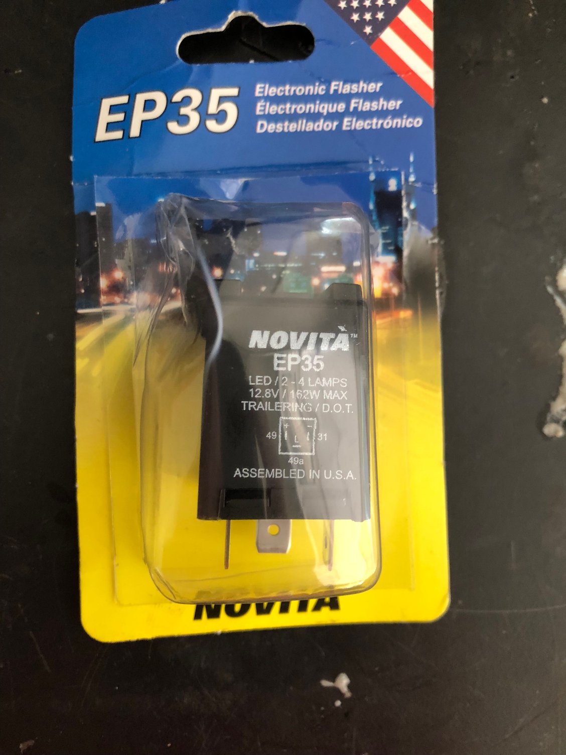

Charles - First of all, the truck is sickeningly beautiful with those fresh graphics....to answer a couple of your questions, yes I keep my Softopper bar in there just like you have it. To be honest, never even thought of pulling it out, and it's never fallen out, although I usually don't drive on the highway much at all with top rolled up. And for the LED flasher relay, obviously the one you have works, but if you get this one, it will plug right in without those jumper wires: https://www.yotatech.com/forums/f199...l#post52364407
Originally Posted by Charles4x4
Soft top rolled up. Does everyone keep the silver bar in the rear rolled up or stored in the cargo area?
Hyper blinker, caused by the LED blinker lights - solved!

Good to know on both! The flasher relay is now zip-tied tight and will be behind the kick-panel, so it's good for now. I may eventually replace it with the one you had posted above - just wish I had found it before I bought the one I did (literally the exact same price)!
