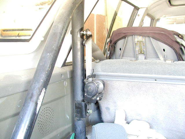

Here's mine, did it today. It took about 30 minutes. These are 4runner front seat belts, the original bolts screwed in the roll bar.
