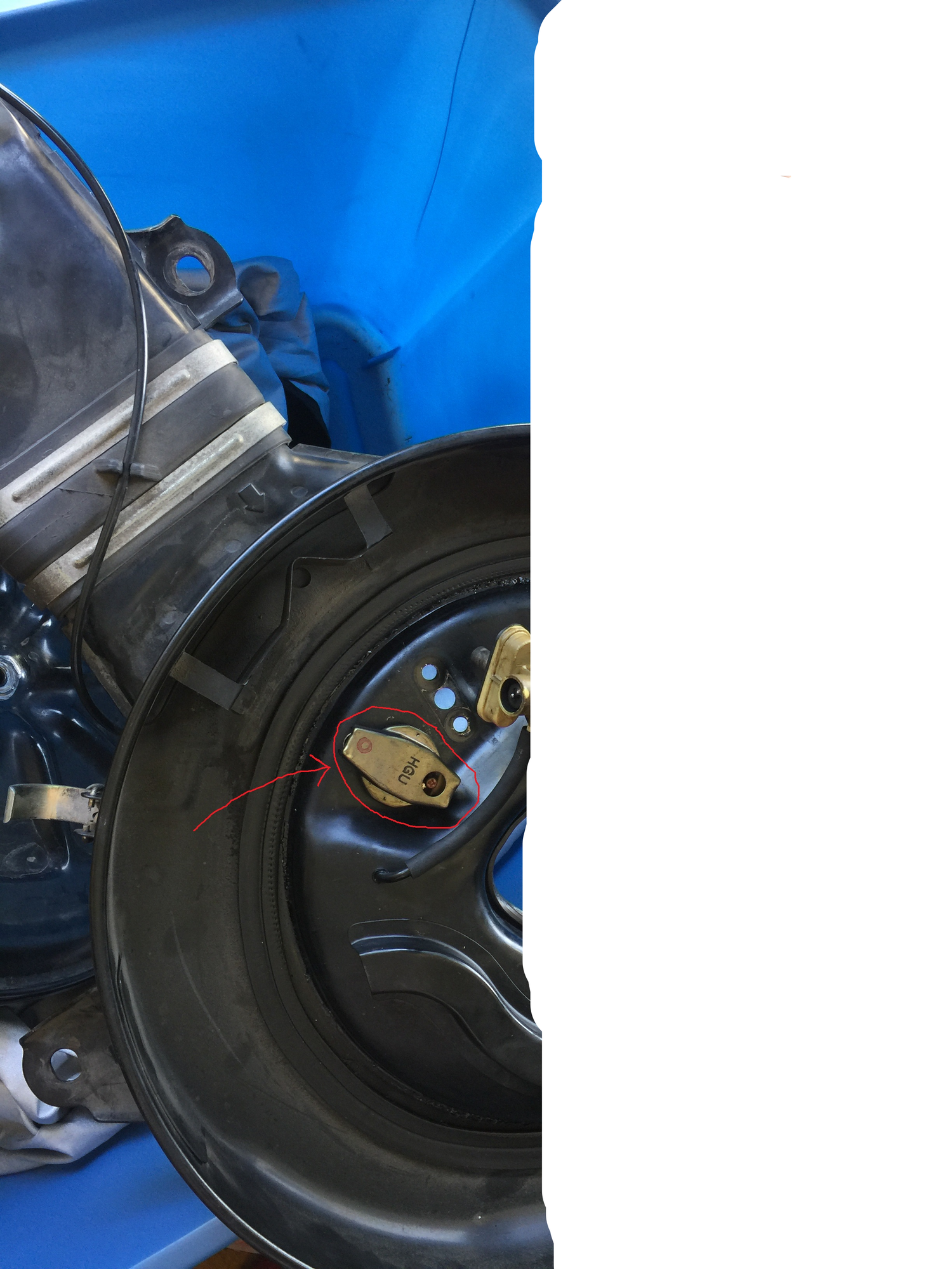

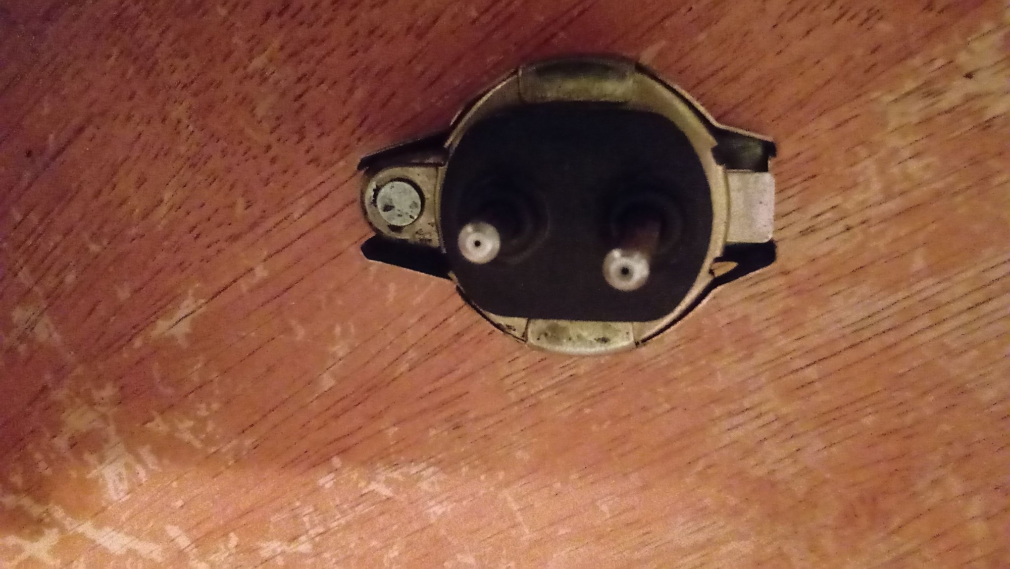

when I took the air filter cover off I found this just rolling around inside anyone know what the hell it is?
any idea what this is, exactly ...and what it does? please HELP.. its my ONLY ride and need it for work tomorrow..

The thing you found in your air cleaner is a thermostatic valve for the Automatic Hot Air Intake System.
This valve controls the vacuum-actuated flapper in the intake section of the air cleaner. The system is designed to improve cold weather driveability and prevent carburetor icing.
Since you found it just rolling around, you probably have a pretty good-sized vacuum leak from the valve being disconnected. This may not be your only problem, but it is at least a problem.

thanks for reply...so that's probably not why the truck cuts off and wont restart....? instead of replacing I could just plug the lines? all of the smog control stuff has been taken off anyway..

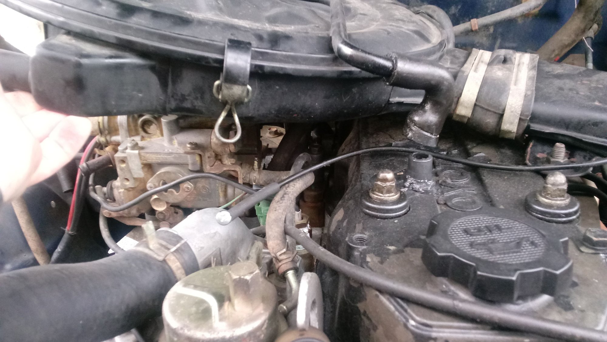

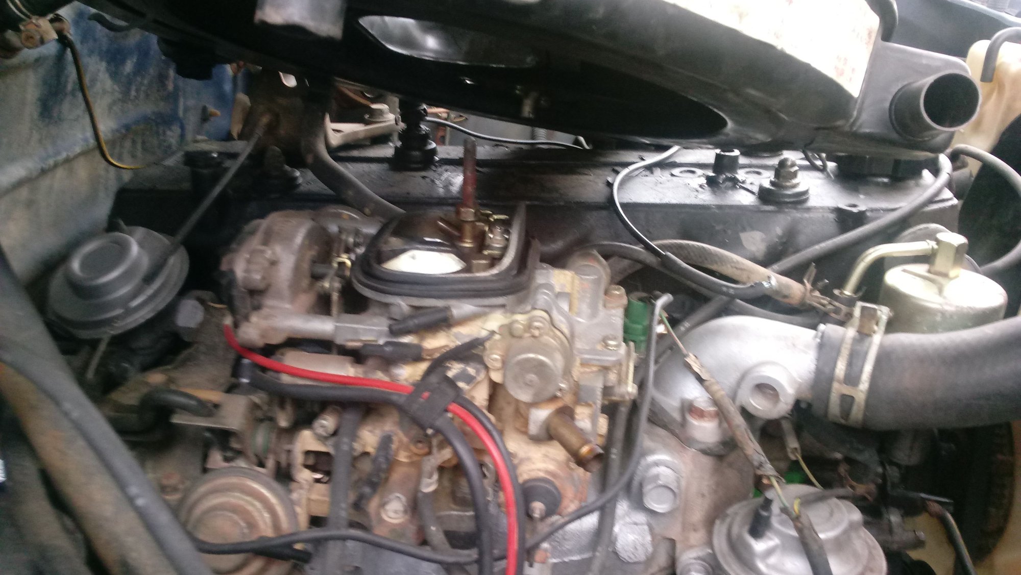

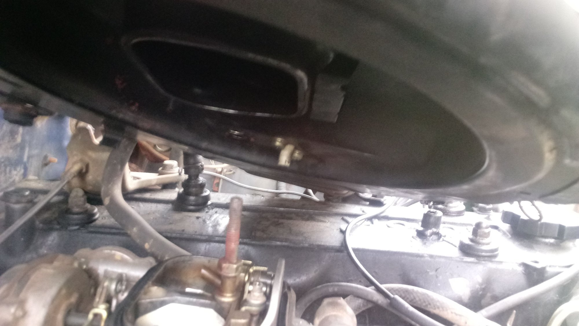

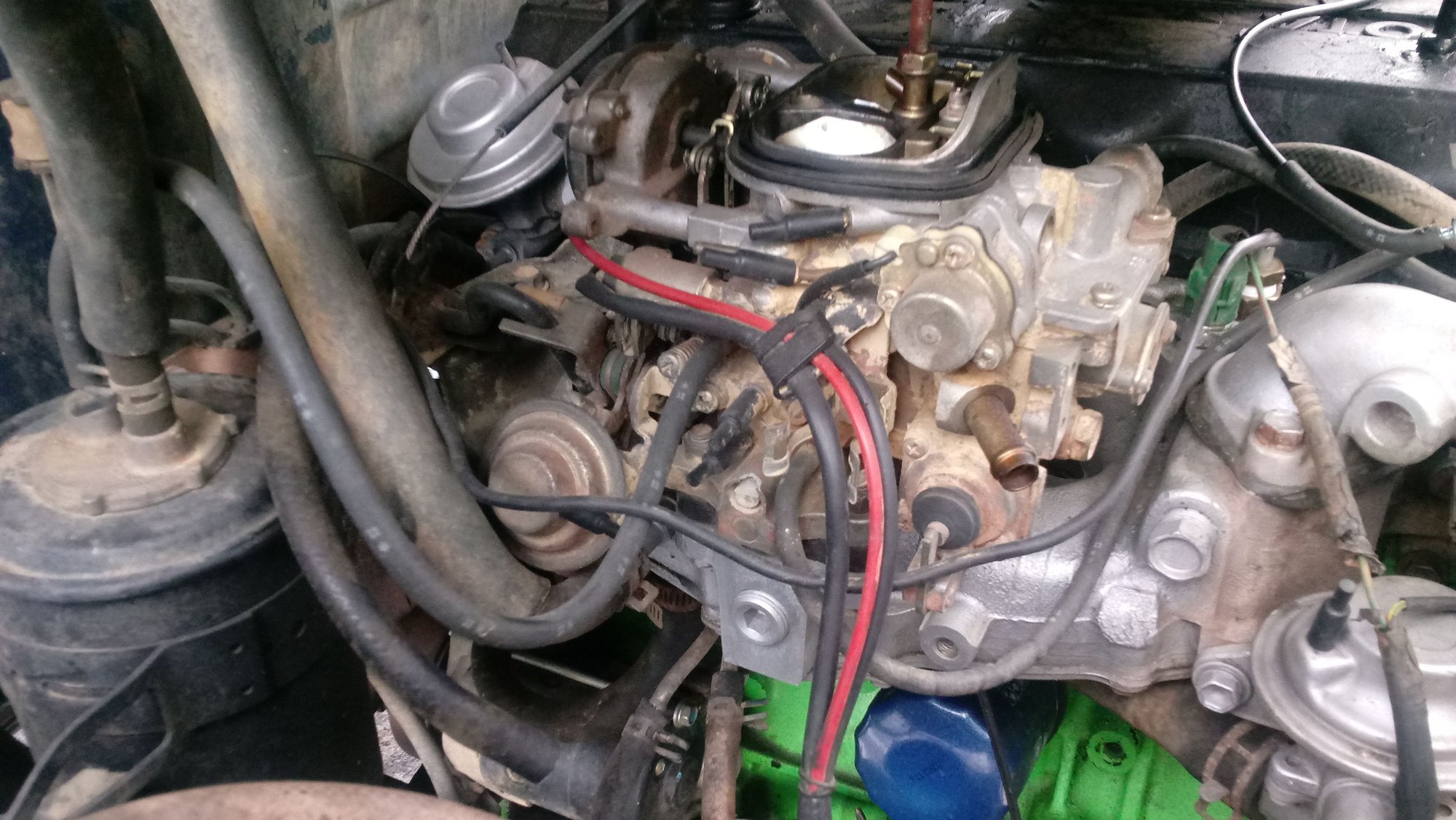

well I tried it just now and it started reluctantly and ran like crap for a few seconds and sputtered to a stop....... here are a few pics maybe you or someone can look it over and see if anything is outta the ordinary..thanks
While it is part of the emissions system that doesn't necessarily make it a bad thing - especially since it is designed to improve cold weather driveability and prevent carburetor icing. Those are actually good things.

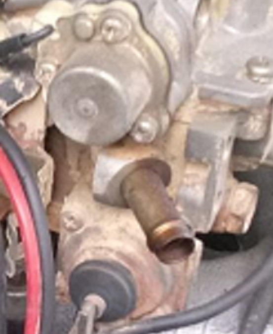

You also have another opening where at least a hose should be attached.
There you go! A picture paints a thousand words...
And I agree ^^^ why not re-mount the loose part and re-connect?
