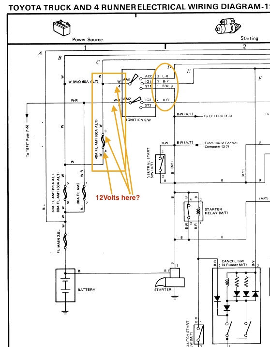

What is the "power terminal"? All pins on the ignition switch are power (as opposed to ground) terminals.
Care to show us on the schematic where you found power and where you did not find power (voltage) where there should have been voltage?

Okay so white and red has 12.67 volts and the white only has seven and a half volts I trace it all the way back to the fuse box and it's not a problem in line so I'm kind of stumped on where else to go

Your 80Amp fusible link that looks like a fuse cartridge ( and that all those white wires connect to) must be blown or connection to it broken. Need to probe both sides of that FL. Do not force it to remove. Try to see if possible to probe both supply and output side of FL first. If you need have no access to test point as fuse block is right now, you'd need to un-mount fuse block, and access from below.

Your meter has such high internal impedance (it draws nearly no current to measure voltage) that you can have a very high resistance connection (a broken wire with a microscopic connection?) and still measure the voltage "on the other side." But as soon as you place ANY load on that wire, the voltage drop across the high resistance drops the voltage to nothing. In that case, you can measure a wanky voltage (7.5?) that's almost meaningless.
The easy way to test that is with a "test light" that has a small incandescent bulb. It doesn't pull much current, but enough to reveal that you don't really have a connection.
Your case is much simpler; the white wire only has two ends! Trace it back to where the voltage changes, and look there.

I finally ended up finding the problem on the main alternator line. It breaks off and splits into a few other wires about two feet into the wiring harness. This runs all accessories in the rig. It was corroded and broke so all I had to do was replace the connection and everything is good

I believe, that's where the thin white "S" wire taps into the thicker white "B" alternator-to-batt wire, correct?. That kind of splice is problematic, gets corroded and/or brittle. (Another splice similar to that causes a coming problem is where fuel injector wires crimp together near/under the intake manifold.)
