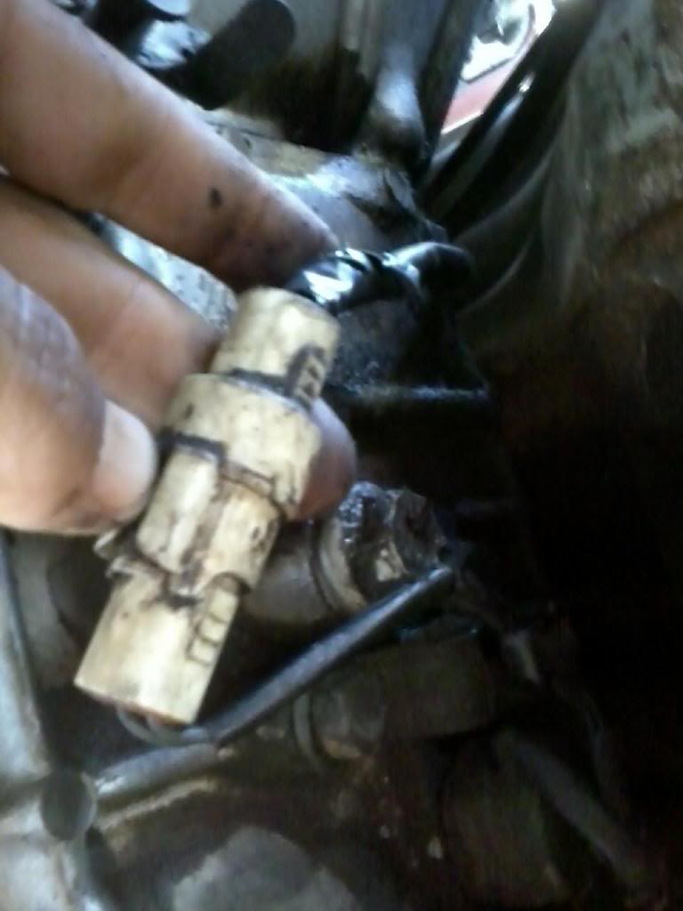

I am not familiar with the digital gauge but when my analog gauge stopped working like you are describing, It was my reverse light switch rubbing against the transmission and shorting out and blowing the ENG fuse located in the drivers kick panel.
Check that the connector is not rubbing against transmission. Mine had just a little bare wire exposed and that was enough to cause it to short and blow the fuse. Where my pointer finger is, that is where I had to wrap it up with electrical tape and I am trying to show in the picture.
