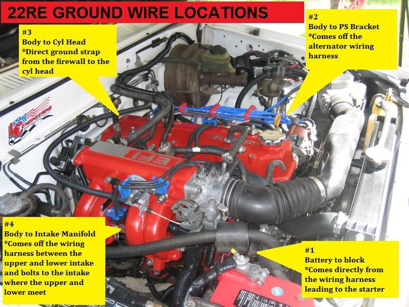

Does anyone happen to know the locations of all the ground wires to the ECM? Not the main battery grounds to the truck, rather the actual ground wires connecting directly to the ECM (i.e. E01, E02, E1). Also, I still have code 7 which the FSM suggest is a bad O2 sensor. Is it possible this is causing the truck to shut down?

There is a ground wire by the fuse box on the drivers kick panel and the one that is on the manifold is the main one for the injectors in the pic below as I understand it. I am sure there is more grounds but these are the main ones.
