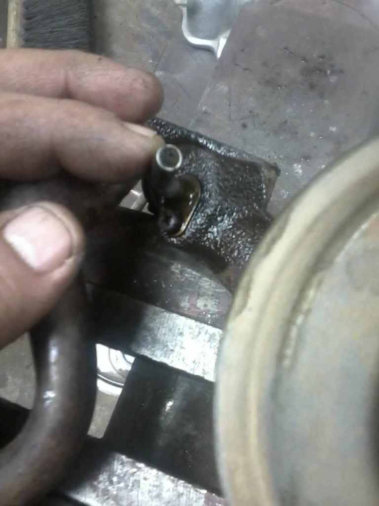

Scope103 is a lot better on information about things like you are asking. As far as EGR questions I can help a little below.
On my air leak and this is a little embarrasing for me, but I didnt have the fan shroud on and the fan rubbed a hole into the pipe is how I had the big air leak. I never heard it rubbing but it took awhile for me to find something so simple. If your fan has possibly rubbed the air pipe, it isnt noticeable from the top. Otherwise scopes103 sounds possible to me.
On the EGR, I have always been able to get mine working just by cleaning them. Then you can put a little vacuum on the pipe and should be able to hear it open and close. I dont have to deal with emissions so dont know how I would do on a sniff test, but it will get them working to stop EGR problems.
Most likely the small vacuum hose is clogged with carbon. The little metal pipe is held on with a Phillips screw. From my experience, you will not get it loose with a screwdriver. I have to take vise grips to get a good hold on that screw and break it loose and then use a screwdriver to get the screw out.
The little pipe is going to be frozen into the EGR and it just takes alot of working to get that pipe freed up from the EGR. I use a drill bit with my fingers to get the carbon out and then I use a bit and a piece of wire to get the carbon out of the EGR and then do the vacuum test.
Maybe scope103 can answer your question better about the EGR malfunctioning and causing that problem. I can get pics later for cleaning the egr somewhere in one of my threads.
Here is the pipe I am talking about and where you put the vacuum on it to hear/feel it operate.
