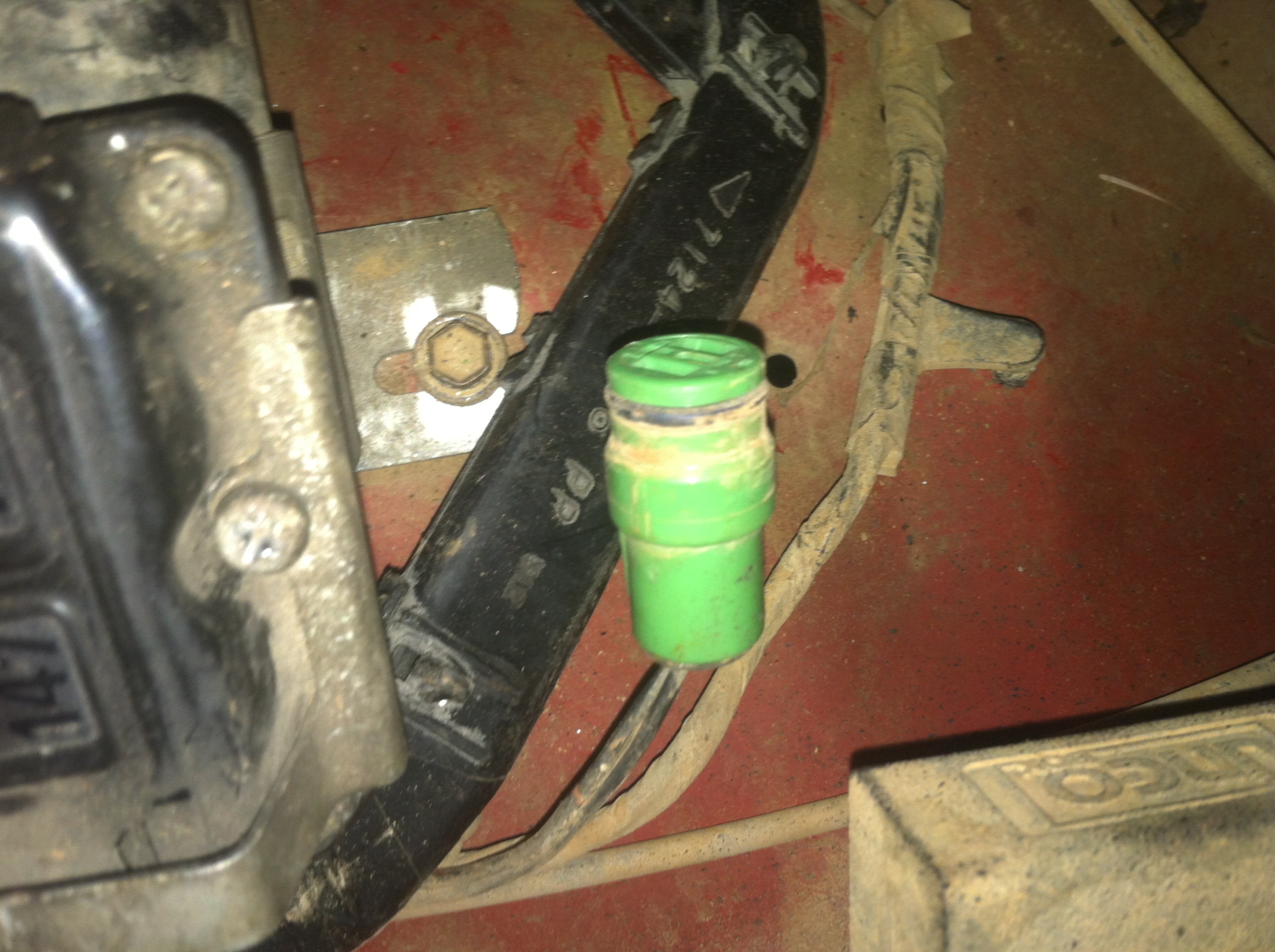

Mine was green until I switched out with the 92 coil so that it would match my harness but there is an extra plug on my 86 that my 92 wiring harness does not have which leads me to believe one of these two are supposed send power to the coil.

Here is the second plug that used to plug into my ignitor ( the first one came off the wiring harness) but now my new ignitor only has one plug coming off of it and my theory is that this plug (round green in picture) supplied the power to my old ignitor and that one of the two plugs I need help with now supply my new ignitor with power
