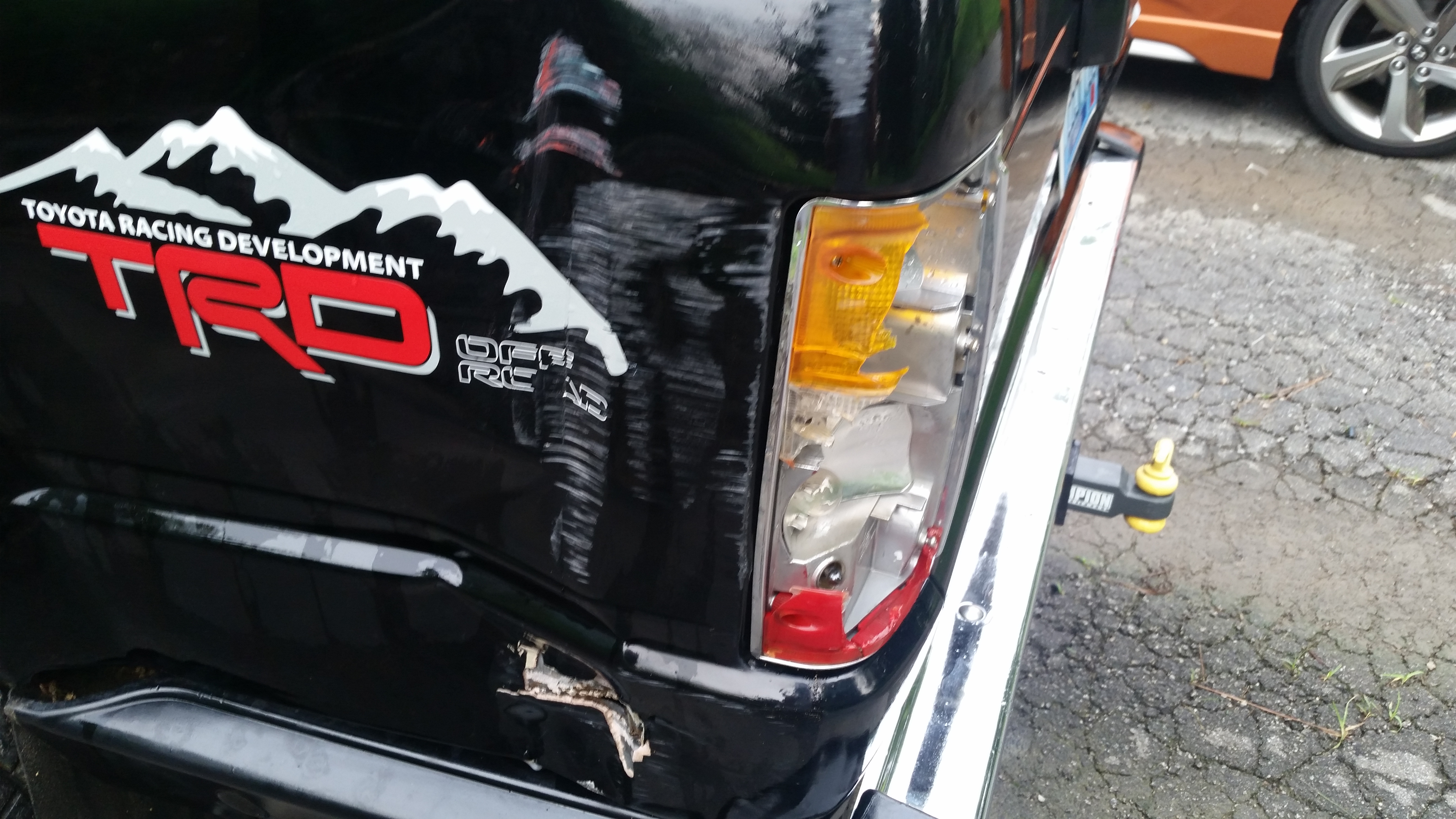

Sorry its taken me so long to reply, I've been busy lately and haven't gotten on Yotatech. I hit the trails over 4th of July weekend and the truck did noticeably better, but the temperature still shoots up when I'm running high RPMs to climb hills and it pings like crazy. I guess I'll try a better water pump. I agree with Odin, the LCE and OEM are probably the same water pump. However, thats not my concern at the moment. I now have a lot of body damage to fix thanks to a guy who couldn't control his jeep and a 12 yr old kid that wasn't paying attention while driving a RZR. Time for more body work....
Attached Thumbnails 22re Overheats when climbing hills-20150704_190401.jpg   22re Overheats when climbing hills-20150704_200859.jpg

Wow sorry to hear about the body damage. Hope it wasn't a daily driver. It just doesn't pay off doing that stuff with your daily drivers.
