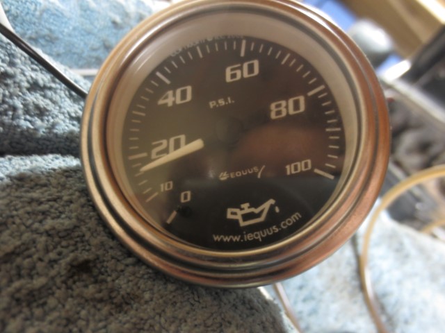

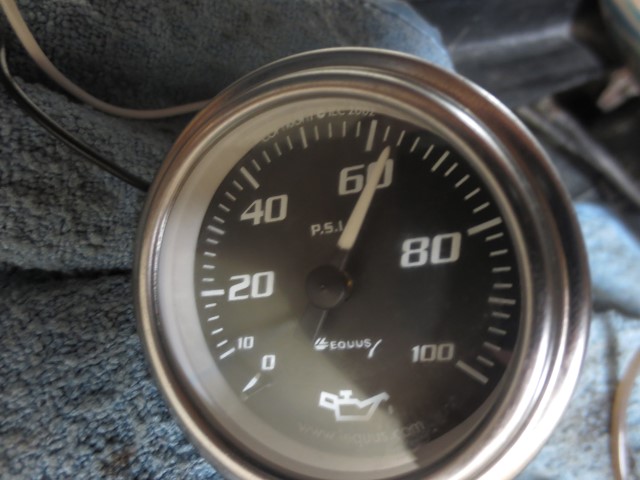

Well I hooked up an oil pressure gauge to check it and I got 20 psi at idle and 60 at around 3000 rpms. Any ideas to why the gauge light is stuck on? Obviously my oil pressure is good...

Install the mechanical gauge and have peace of mind.
It seems the light has just a switch where the gauge has a sending unit.
Once the oil pressure drops below 4.3 psi the switch closes completing the circuit
Switch/ Sending unit
Wrong part for your light.
Someplace the circuit is going to ground lighting the light.
Simple to check with a meter
