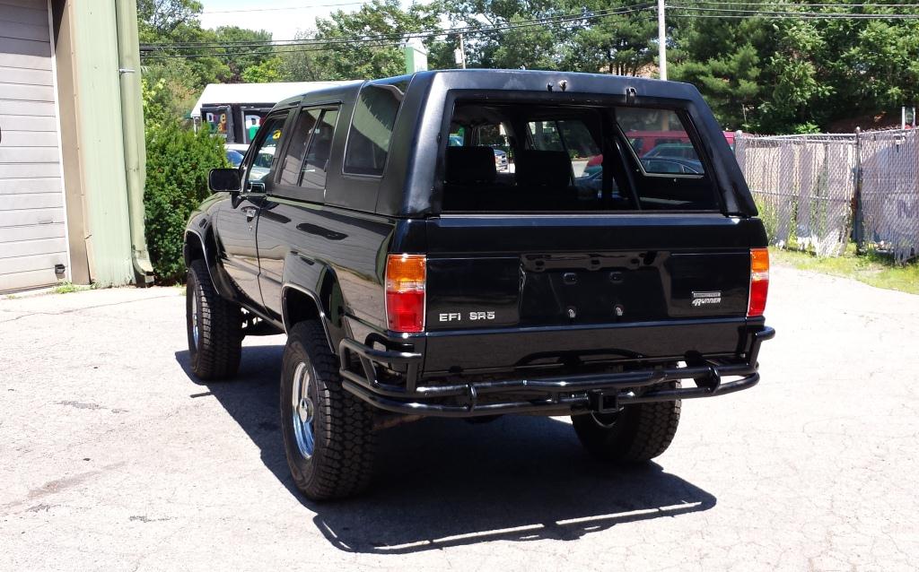

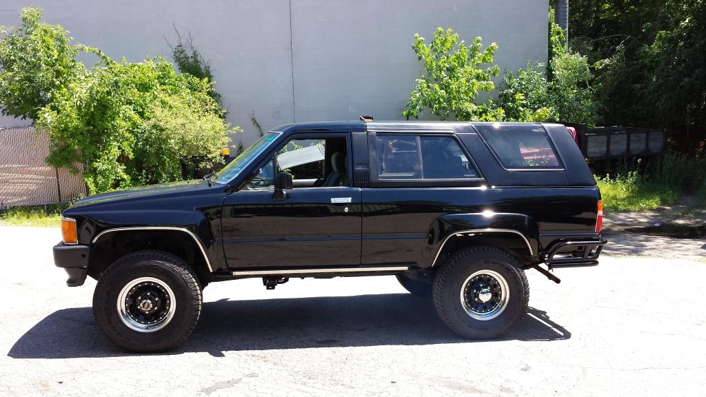

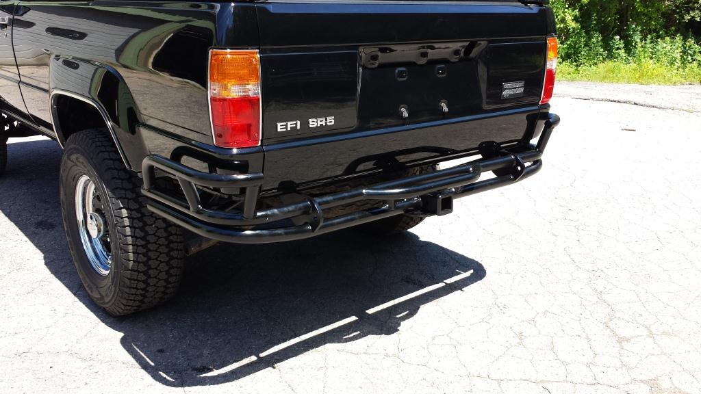

UPDATE!!!! This thing it pure beef! I got it in October and it was waiting in my basement for the install.
I used a 80 grit flap wheel on my angle grinder to get the surface rust off, then followed it up with POR15 Marine Degreaser and then Prep&Ready. Some clean metal primer then some Rustoleum Semi-Gloss Enamel and it is good to go!
If I was forced into suggesting an improvement the only thing I can think of is to make the bracket that inserts into the frame a bit longer. If it was 3-4" longer it could utilize a 3rd bolt on each side. Might make it beefier than two bolts per side. It would probably require taking the tailgate off for install though.
Don't mind the greasy handprints...

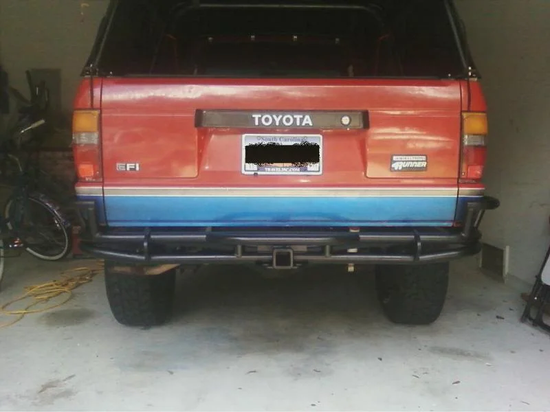

Hey man! I've got the trail gear rear and while it is cheaper, it is cheaper... Get it? A backed into a tree going a mile/hour and it bent it completely. Marlin crawler has the bars that connect from the side to the frame which is what trail gear needs. I'm not sure of the 4xI has those or not. I recommend the 4xI over trail gear. And with it being rated for towing, you can have a sense of ease when you're pulling a buddy out of the mud!

FYI... The 4xInnovations comes with the side brace tubes that Trail Gear has as an add-on welded in already. It weighs 110lbs and is super beefy. It will bend the frame before the bumper gets bent.
