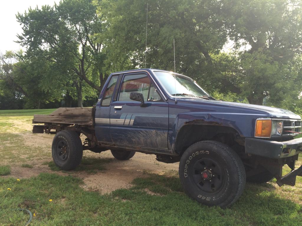

Here's the truck

You will need a extra cab frame, but you can use one if it came with a carburator setup. You will need to change out the fuel tank and the botto line on the passenger side of the frame to keep it fuel injected, if it is fuel injected.

Dam thats some bad rust. Hows the front of the frame?

With the rust in the rockers, cab corners, fender and frame...I personally would be looking for a different truck altogether with mechanical issues.
To each his own, but that definitely truck doesn't look worth a frame swap to me.
