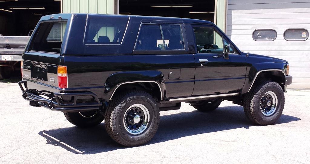

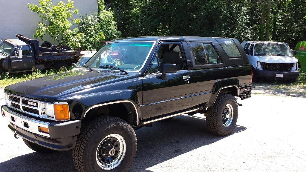

UPDATE!!! So the restoration is 99.99% complete. The 4xInnovations bumper is on and the top is back on. Here is my review on the Black Magic 5" x 11" 125lb springs.
I'd say with a stock bumper this would absolutely be perfect to get you back to stock height. With the bumper on there it gets lowered by 0.5-1". Still looks perfect, but throw a couple people or some gear in there and it would be a little squatty.
With a heavy rear bumper or if you are frequently hauling gear....I'd go with the 13" 125lb springs. Once I put some sliders on I will be buying a set.
Here it is with the 5x11" 125lb springs.

It looks great. Perfect stance. Did you have your truck repainted at any point? The black paint looks terrific. Do you use any special products? I suppose I could wash mine one in a while.

Thanks! I tore it down to its skeleton to rebuild it, so yes it has been repainted. One year ago almost exactly. Just finishing it up now. There is no wax or anything on it....once I do polish and wax it it will look like a mirror.

Truck looks good, AdmiralYoda! I can't wait to get my shell painted.
Originally Posted by Nervo19
I just read your earlier thread. Holy cow. You should be very proud of all your work.
Amen to that!
Originally Posted by AdmiralYoda
With a heavy rear bumper or if you are frequently hauling gear....I'd go with the 13" 125lb springs. Here it is with the 5x11" 125lb springs.
Sounds right.
Your 11-inch 125-pound springs are a little low for added weight.
My 12 inch 125-pound springs are just right for stock.
13-inch, 125-pound springs would be just perfect for your load.
