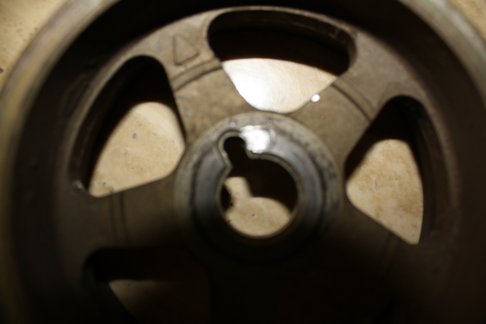

OK I have an update, finally had some time to work on it. Pulled it apart so I could pull the heads, Made a cam tool to take the pulleys off, and it worked great, and I found the PROBLEM!!!!! the dowel that pins the cam to the pulley was sheared allowing the pulley to rotate about a quarter of an inch. Now I need to figure out how to get the rest of the pin out of the camshaft. I'm going to try and post some pics have to figure out how first.
Another question is when I did a leakdown on the cylinders all the valves seemed to hold ok i turned the cam while i was putting air in but when both valves were closed it still leaked air really fast probably past the rings, couldn't tell where the piston was in relation to tdc and the engine was cold and had sat for a couple weeks before testing. Now should I still pull the heads or just get a new pulley and try to ez out the pin. My guess is they didn't tighten the bolt enough when the previous owner had the heads done.
So here is how this nightmare appeared to have happened CSI style. Small bolt that holds on the timing belt cover fell down inside lower cover while yahoo that did the head job was putting everything back together. ran for a few thousand miles when the bolt decided to come out of its hiding spot and wedge itself between the lower pulley the belt and the lower cover, causing the weakest point the passenger side dowel pin to shear and maybe the timing belt to skip, but now thinking about it I don't think the belt skipped at all just the pin sheared. And viola pain in my ass for the last 2 months or so.

Lets see if this pic works

So, indeed that cam appears to have been out-of-time. I suspected such when I asked the question back in post #6 just did not figure it was an apparent mechanical failure.
Good luck.
