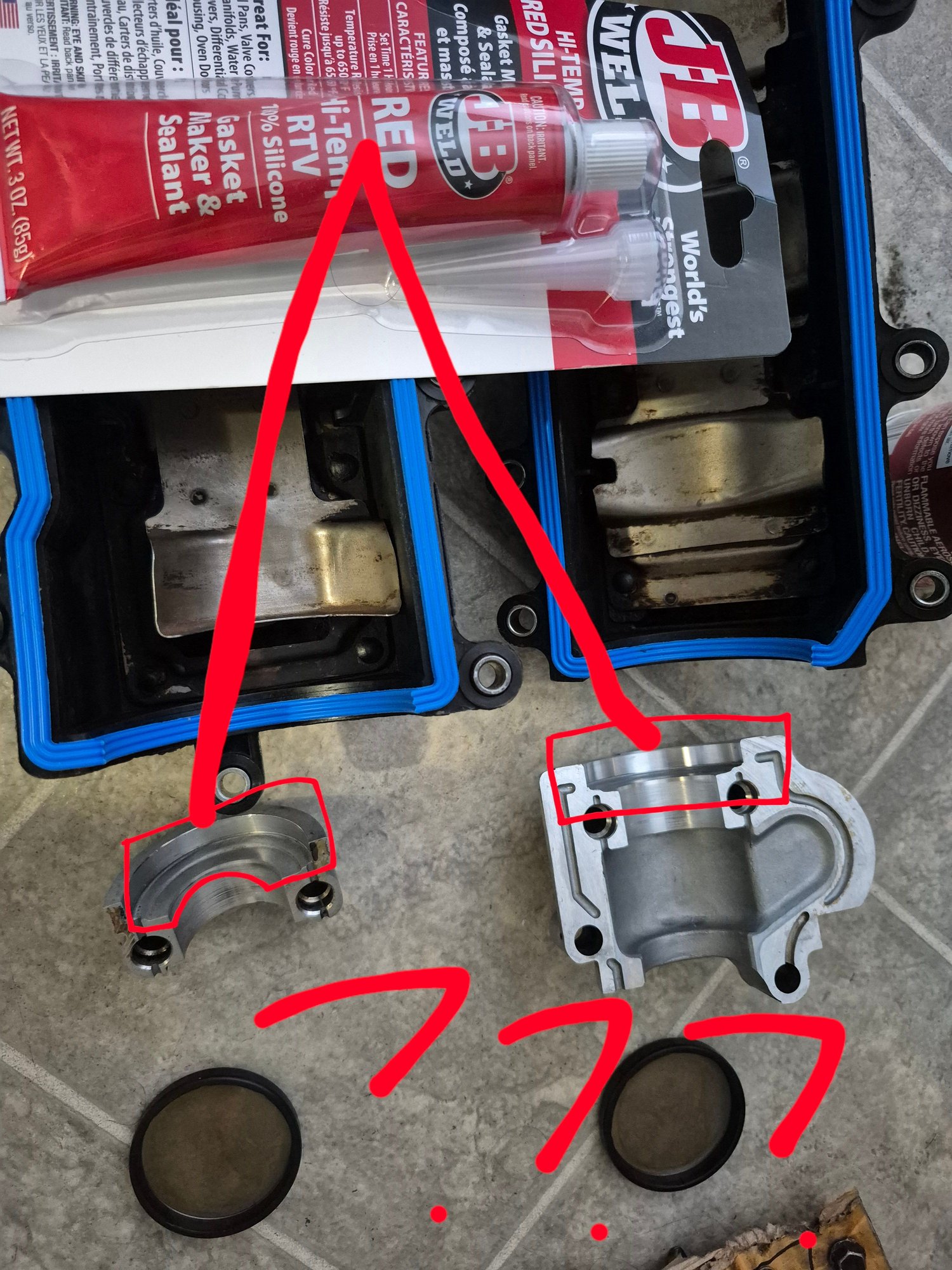

Old Oct 12, 2025 | 03:40 PM
Oleonetwo's Avatar
Joined: Oct 2025
Posts: 2
Half moons???
Originally Posted by ToyoTech559
make sure the leak isnt coming from the half moons. i have replaced both my valve cover gaskets and halfmoons. only added a small amount of FIPG around the half moons. you shouldnt really have to add any gasket maker around the entire gasket imo. since you have taken if off so many times. just buy a new oem gasket and redo it
also if your gasket has any oil on it. the gasket maker wont work, same if there is oil on any part of where the gasket would go. make sure everything is dry of oil
Are the half moons referencing the metal part that covers the rear portion of the valve cover gaskets? Like the metal part that holds the cam plugs in place?
Old Oct 12, 2025 | 03:47 PM
Oleonetwo's Avatar
Joined: Oct 2025
Posts: 2
Originally Posted by wrenchmonster
Stumbled across this thread and wanted to add a few things. To help prevent the round rubber cam plugs from leaking get rid of the factory metal plates with the large hole in the center. Why Toyota put a big hole in the center is beyond me, but I digress. Anyway, take a few minutes and fabricate covers that are solid. I personally used a slightly thicker aluminum and slightly longer bolts. Then when it comes time to put the plug covers on, clean the surface really well and silicone them in place. This is kind of a belt and suspenders move, but it helps to keep the plugs from leaking. As noted by another poster above, no need to overdue the silicone on the cover itself. Simply follow the procedure in the factory service manual as far as silicone placement in the corners. Clean everything super well, including the bolts. I like to use blue thread locker on the bolts. Torque spec is 5.4 NM. You'll need a 1/4 drive torque wrench for this job. And follow sequence, which is basically from the center bolts out alternating sides. It may also help to suck out the oil from the head as it likes to rest just barely at the bottom, which if you're not careful oil can spill over the edge as you're leaning on the truck while putting the valve cover on. So take a few minutes and suck the oil out, or tilt the whole truck depending on which side you're working on.
As to the last question on this If you lose a metal sleeve in the valve cover, one can be made by cutting a roll pin or metal tube. The only thing here is that you'll want to measure the sleeve with a digital caliper to get a precise length. The sleeve is there to help ensure the gasket isn't over tightened and squished down too much.
-Kevin
I took my covers off just to clean my engine and started ripping parts off and deciding to fix them all up, my driver side cam plug was put in backwards, any answer to whether this was intentional as some sort of engine hack? or did the previous individual just ˟˟˟˟ it up and put it in there backwards without noticing?
Old Oct 13, 2025 | 03:57 AM
scope103's Avatar
Joined: Sep 2007
Posts: 8,379
Likes: 871
From: San Francisco East Bay
On the 22re, there is a half-circular plug in the front. On the 3VZE, the valve cover has half-circular cutouts to fit over the camshaft bearing caps. There's a recommended placement of RTV on each side of the bearing cap where the valve cover gasket makes a rt-angle turn, and if not done correctly it's a source of leaks. I think the reference to "half-moons" is a conflation of the half-circular 22re plugs (there are none on the 3vze), and the writer is almost certainly referring to the bearing caps.
Do you have the FSM? https://web.archive.org/web/20120813...68cylinder.pdf
