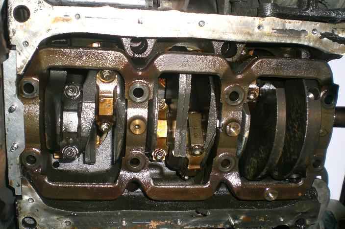

Im just trying to get the main bearing cap off!!!!! This chilton's manual I have implies that you can get the main bearing cap off without the engine out of the truck, and says that the main bearings can be replaced with the crankshaft installed as well.
So, I came to the conclusion that the bearing cap wasn't going anywhere as easy as the book suggests and began taking everything else off including the oil pump, which I thought would provide enough clearance to wiggle the cap loose.

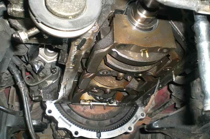

Now I still have the rear oil seal retainer (very left piece on block shown) clearly blocking the cap from sliding out.
Has anyone else come across this issue? They made this engine with the idea in mind that you are able to maintenence the main bearings without engine removal.....but please dont tell me I have to remove the tansmission just to remove this retarded cap!! Ill grind the bottom of the rear oil seal retainer before I go there lol.

Looks like it is hitting against the rear oil seal retainer
Old Dec 21, 2010 | 11:22 AM
coltonstewart's Avatar
Joined: Aug 2010
Posts: 82
"Now I still have the rear oil seal retainer (very left piece on block shown) clearly blocking the cap from sliding out."
Haha yeah, I am aware of that, just want to know if theres a more viable alternative to removing the transmission or grinding the seal retainer.
There should be, or else this one piece is contradicting the practicality of the engine design. The access to this part of the engine without removal of the engine or crank is a characteristic developement in the 3vze, so what the hell.
Screw it, i think im just gonna grind the seal retainer....I dont yet see any function for that overhanging piece, nor do I forsee any complications with the oil pan seal or anything....

OK, having rebuilt my 3.0 if you grind on it i fore see a sealing problem when u go ahead and place the oil pan back on.
Old Dec 21, 2010 | 02:20 PM
rustyf99's Avatar
Joined: Jul 2009
Posts: 107
From: 60 mi west of Chicago
I think the greater concern would be the strength of the stud mounts in that retainer if you grind enough off of there to get the bearing cap out. I guess it's worth grinding if you would rather get it done and are willing to take the risk of the oil pan leaking or having to re-do some other part of the work again later. I know that's not what you wanted to hear but these engines are PITA's to work on and really, it's easier to yank them. But I know where you are, I've rebuilt engines while open to the weather on a gravel driveway. Good luck!!

Yeah I can see that if i grind ill end up having to seal the hell outta those mounting studs and baffle plate. The studs dont hold alot of weight or tension so I think its worth the risk grinding...
