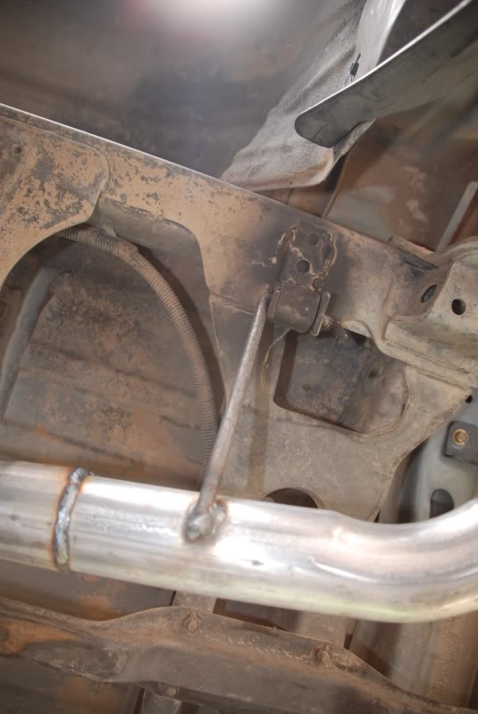

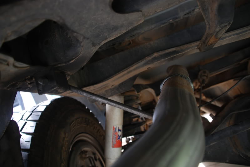

Did you install that hangar that holds the tail pipe? I forgot to do this during my cat-back install and it was banging around made an awful sound when I turned the car on. I didn't notice it in the pictures so just seeing if that was done.
Yes, I took the stock hanger out, installed a new, stronger one. its welded to the frame and supporting the tip. more so than the stock one which supports the tail pipe. so yeah. my exhaust tip hangs down enough to clear the stock bumper and not rattle, but yet still holds it strong.
Pics of that? I used the stock hangar and it's already rusting out pretty fast. Wanted to go with another idea.

Sure do. The clamp is custom, but does its job. Here it is.
If anyone else has any other questions or things they would like to see... feel free to ask. Camera is available and I can take a picture of what ever

^ ^ So, where did you find that clamp from? Looks pretty stock! Great location and research.
