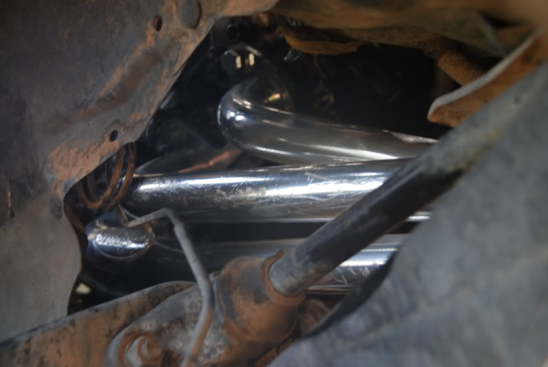

I was taking another look at your pics, and it looks like you might have a bit of an issue with your brake lines. They look like they might be close enough to the pipes to get fairly hot, possibly hot enough to boil the fluid and put vapor in your lines. The line to the clutch slave cylinder is worth a look, too, along with the fuel line & return line. I think you might consider some heat shielding - sleeves or tape might be a good idea. Summit carries a ton of heat shielding stuff:

Defantly move those lines. And be carefull about the fuel lines on the other side. They can burn through quickly!

I've bent the brake lines out of the way, Fuel line is already heat wrapped. I'm gonna buy some wrap for the starter though... that is extremely close to the passenger side header... heh

alrighty, thanks. I was jst going to wrap the brake lines, put more over the fuel line, and some over the starter. and call it good.

Alrighty, thanks for the info. I just bent my brake lines and zip tied them ( not like it'll matter, they'll just melt ) but by the time they melt they should be pretty stuck. they are no longer resting against the header... still gonna buy some wrap for it though... esepcially the starter... feel bad for the little guy under there lol
