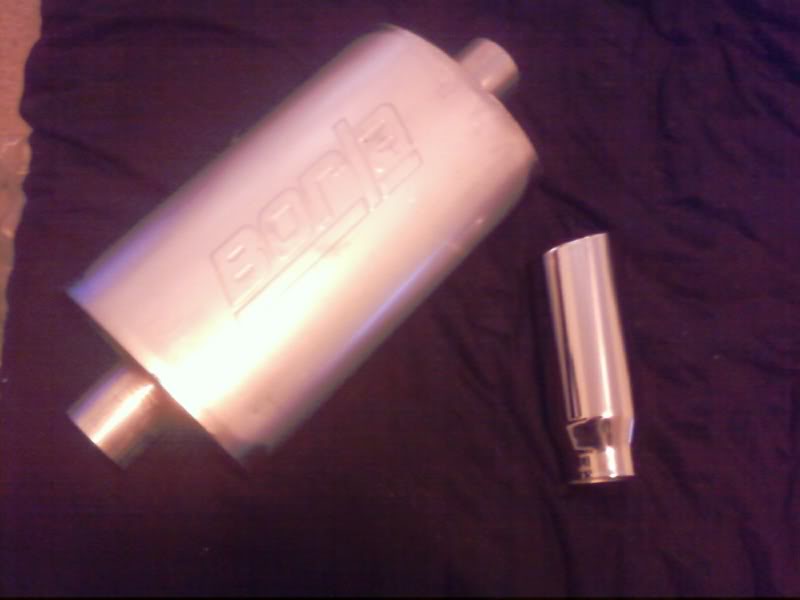

Old Sep 27, 2009 | 04:53 PM
MaK92-4RnR's Avatar
Joined: Mar 2008
Posts: 6,059
Likes: 101
From: Sacramento, CA
heres a little eye candy before installation

Old Sep 27, 2009 | 05:01 PM
Jay351's Avatar
Joined: Feb 2007
Posts: 9,055
Likes: 10
Yeah, those cast suckers are heavy
So, I gotta ask, how does it sound??
oh yeah, make sure you keep an eye on your fuel lines around the passenger side header. My friends headers burned a hole right through the fuel line!!
