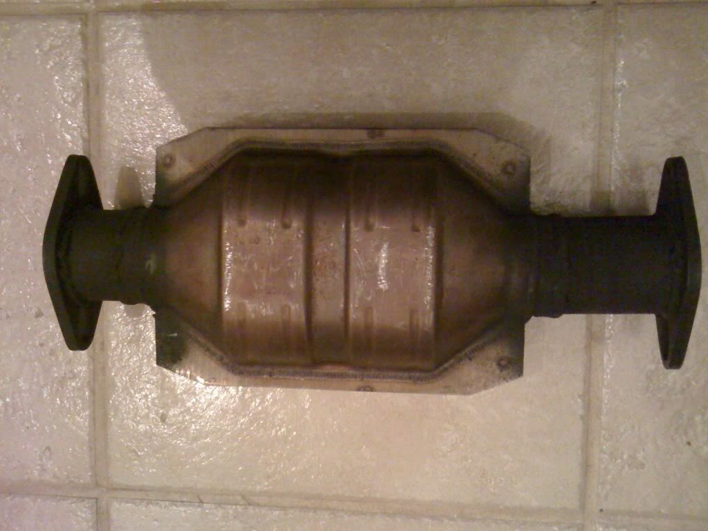

heres the cat, and the flanges. bolts directly in with 14mm bolts.

did you have to weld those on the cat or did you buy the cat with those on?

Welded on. my exhaust is 100% custom.

ya i have the same cat you do i might just do what you did but i dream of having headers one day. lol
