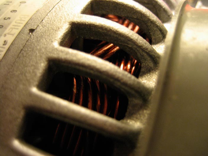

I did the Boyle's Future Tech alternator upgrade. I am really happy with it now, it is very solid and a whole lot more powerful than before (65 idle/124 max).
The thread on that is here
https://www.yotatech.com/attachments...ics-boyle1.jpg
https://www.yotatech.com/attachments...ics-boyle3.jpg
I had an issue at first, because the first one they sent me was defective and wouldn't charge properly at idle. I sent it back to them and they rewound it, this time adding insulating varnish, and it's been perfect ever since. They offer a great product. My only advice is to send them your old alt in a very, very excellent box, really well packaged, and request that they send it back in the same packaging. Both Mt_Goat and myself had issues related to damage in shipping due to poor packaging. good luck this will boost your charging system a whole lot!
