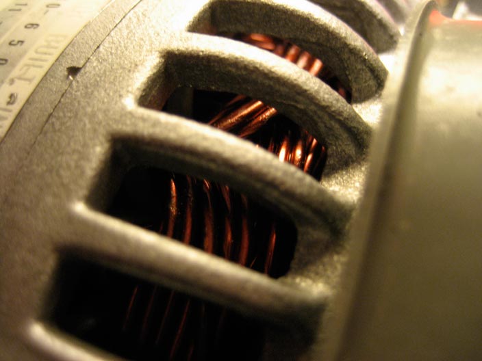

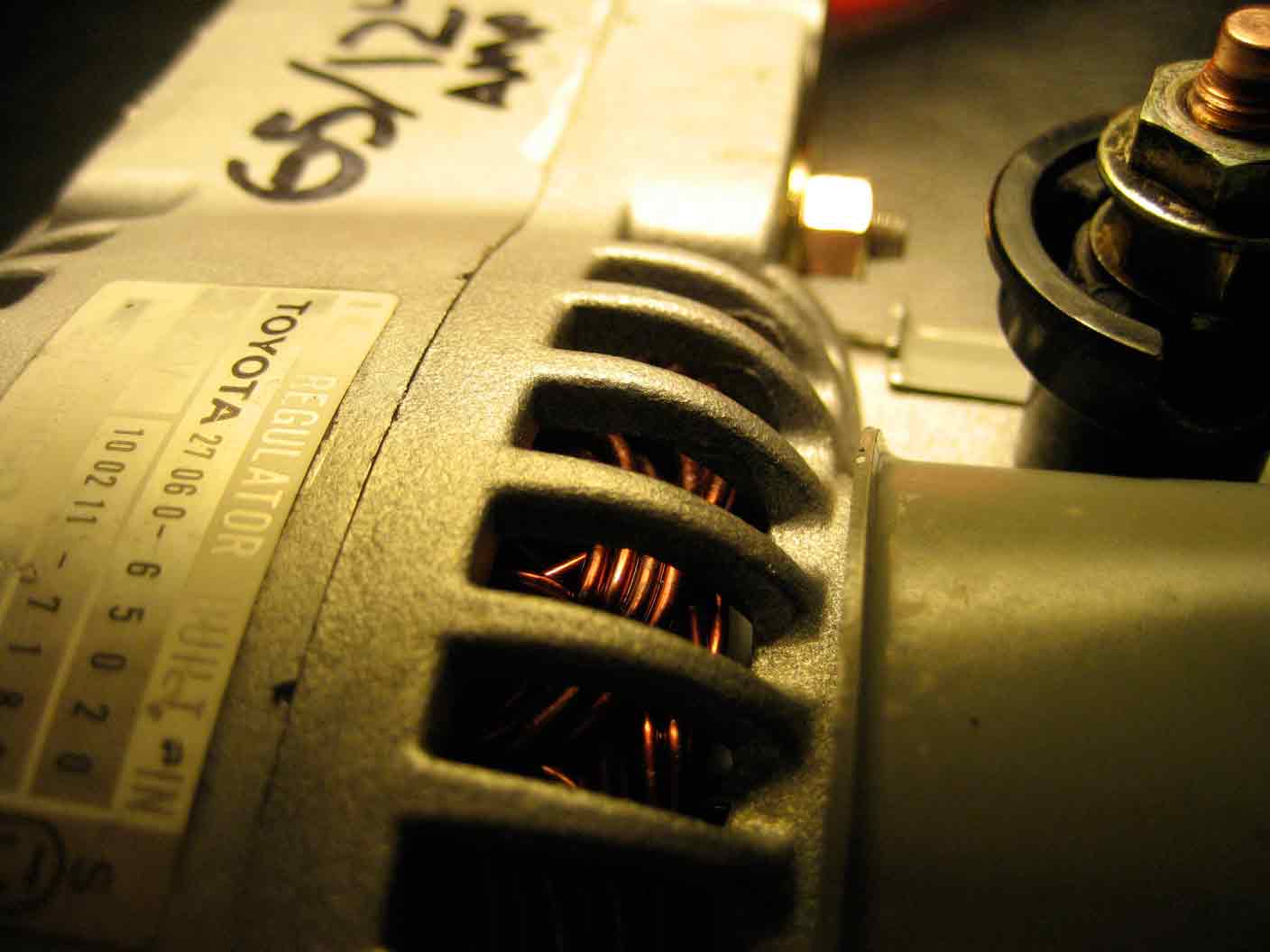

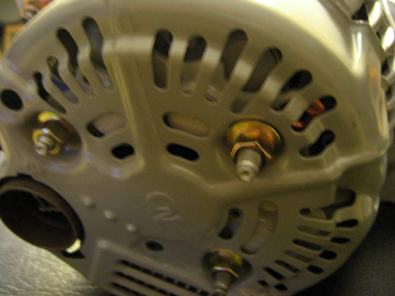

Got the Boyle's Future Tech rebuilt 2nd gen alternator back today. looks clean Here's some pics...

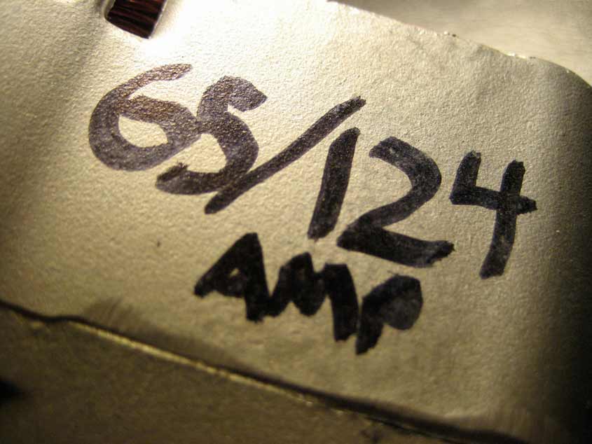

what do you think about the new specs? I think it's kind of cheesy that they wrote the new power rating in black marker right on the alt, would have been better to have put another sticker on there with it typed...looks not professional but not too big of a deal. the insides look like some beefy coils in there, very heavy too, the price was more than I thought, has gone up to $165 plus shipping, total of 175.64

more pics, boyle alternator
more pics of the boyle 2nd gen alt! hope to hear an opinion about how good the rating is, 65 idle 124 max
