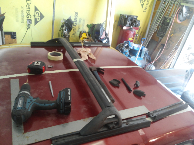

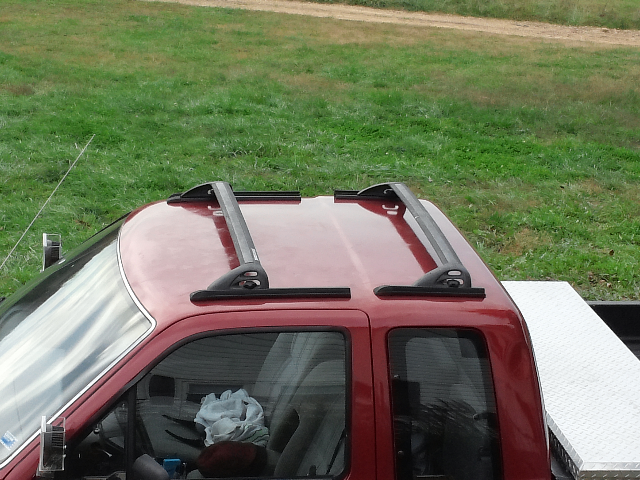

I added nutserts (rivnuts) to the roof of my extended cab pickup with cut down 4runner rails for my roof rack. I didn't put backing plates on it as it would have been extremely difficult, however with the rails and cross bars put on it is extremely stout and I can hang all my weight on it with no deflection, as it distributes the weight pretty well. I would have no issue using rivnuts on something like this again. I will be making a basket with lights and probably put my spare up there as well when needed
