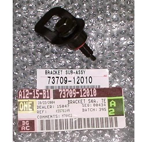

Here's how to install a top tether. The threaded hole is already there. You just need the part from the dealer.
https://www.yotatech.com/forums/f2/a...2nd-gen-53369/
Toyota has a bulletin out about this. I'll look for it and add it to this topic.

Here's the Toyota Service Bulletin for installing a Child Restraint Seat Top Strap Bracket
http://www.the-roo.com/4runner/Servi...s/bo010t02.pdf

Thanks again. Now that I had the day off, I headed over to Shane's shop space and since he also is on the road to parenthood, he was gracious enough to let us watch him perform the retrofit to our 4Runner as well as his.
Since the procedure was similar, but with some small differences he took some pics for me to link in.
Also, FWIW, part #73709-12010 has been updated to a new one, keep that in mind when you ask for this piece. It was around $15-$25.
I'll clip in his writeup in a second, once I copy everything down.

Basic template of the mat that is under the carpet showing the two 2"x2" points you need to cut out of the carpet.
Remove the rear sill plate trim by popping the plastic covers off. Do this at the 9 or 3 o-clock points, looking forward into the cargo area. Use a #0 or smaller standard tip.
Remove the rear sill plate trim by popping the plastic covers off. Do this at the 9 or 3 o-clock points, looking forward into the cargo area. Use a #0 or smaller standard tip. Then remove the 5 phillipps screws using a #1 phillipps.
Rear sill plate pops up from the outer edges. Check your plastic carpet keeper piece and replace the factory staples if necessary with high gauge staples. (Like you would use for stapling large packs of paper.)
Front portion of the carpet pulled back will reveal the anchor point.
Peel back the sticker to gain access to the anchor nut. Use anti-seize on your bolt and tether anchor. *Preferably, use silicone or FIPG around the base of the bolt-washer to prevent any moisture from getting through.
