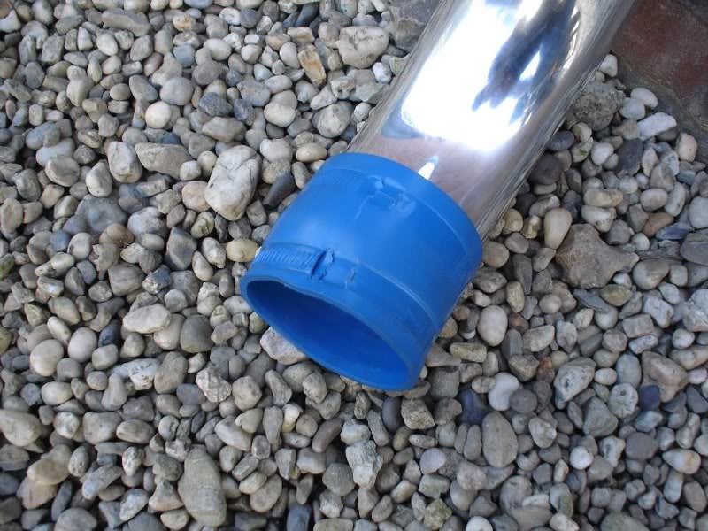

I immidiately mounted the new SS clamps and this is what the first silicone coupler looked like after removing it:
Mmmh, really good stuff. As I had everything in my hand I also found that the silicone couplers are made of the same quality or originated in the same crappy factory. probably made from recycled condoms..

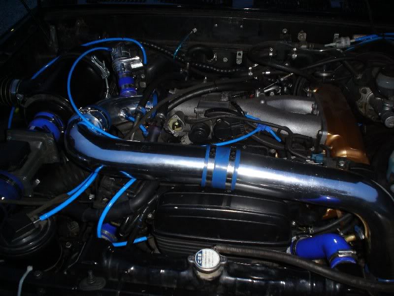

In the meantime my supervisor pointed out how to gain some additional horsepower:

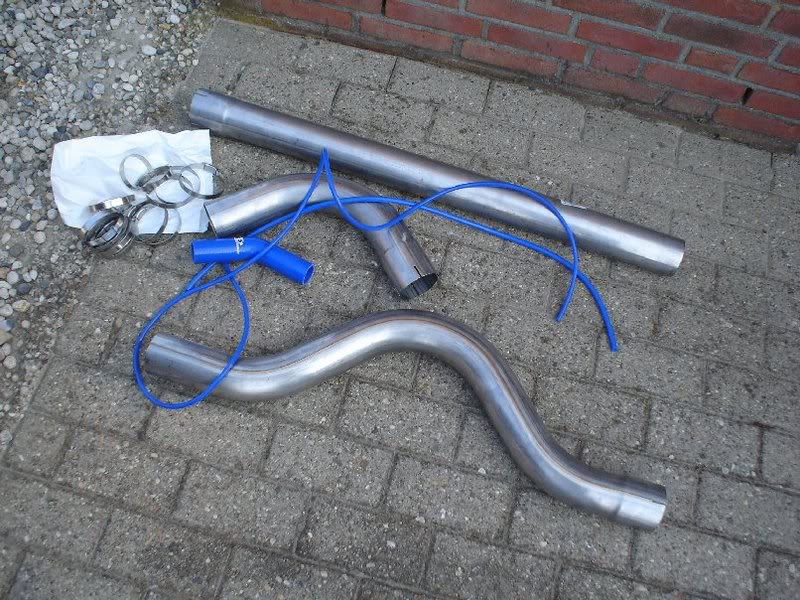

Also have my weekend planned sine the exhaust parts came in.
3" thinwall SS like I hoped. The testpieces look okay and are leightweight considering its SS. I also ordered an 'axlehoop' which is probably a bit low in height, but I can lenghten it easily with 2 small pieces of straight pipe.
Still considering making my own muffler out of the old SS BMW I run now. Just have to build a larger bore perforated tube in it and repack it with the old SS woll.

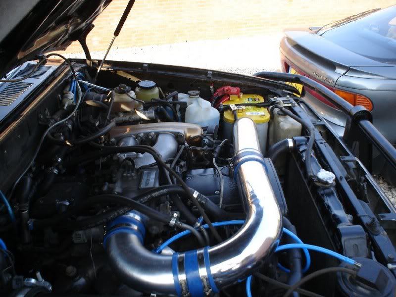

Had a change to do dome work last night and this afternoon, so i started welding some connections to the last intake bend. The big one is for the BOV, the small one for the idle up from the powersteering. Also buffed it up to give it the same look as the other pipes.
Hooked it up fast cause someone dropped off a 4R for an overhaul and I wanted to take a testdrive with the BOV functional and in daylight.
So I did make a testdrive and took the guy and his wife with me
With full throttle I managed a topspeed of 110 mph (just dropped into 5th gear) with 3 passengers, uphill within a 2 miles distance before an emergencystop I guess about 105-110 in 4th at 7100 rpm at just under 5 psi boost. Only thing I'm really sure off is the top speed and boost, I was busy concentrating on not taking of in the curve
I'll try to hook up my digicam somehow in the back of the 4R and post this weekend.
