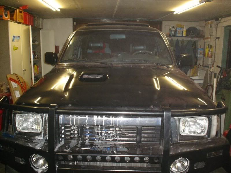

#45

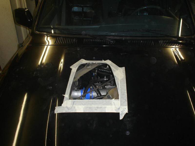

hoodscoop
Gathered some parts this week, plus the new intercooler is in
I started with getting some fresh air under the hood.
Fired up the angle grinder and this is the result af tonight:
I bought a polyester scoop and am now altering it so it can be glued on.
This is how it should look:
I used some fiberglass to prepare it for final fixing. It's drying now so i should get it finished tomorrow.
I also opened the front so fresh air can get in, just think I should mention it before people start making smart remarks
The intercooler is the maximum size I can fit (3" in and outlet) behind the bumper, it's gonna take a lot of cutting to get it to fit:
I'll post another update tomorrow.

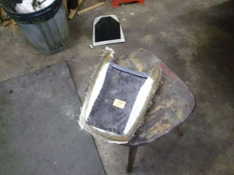

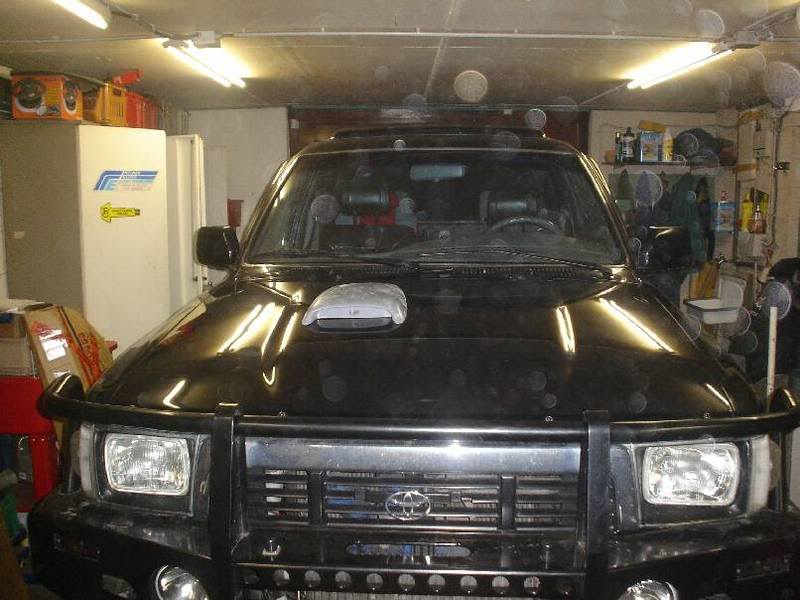

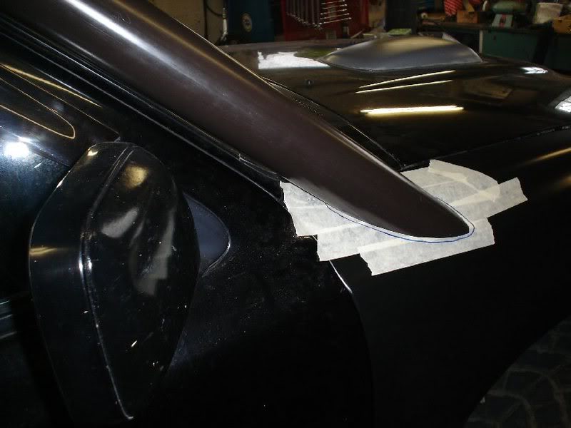

Did some more work today. Removed the scoop and it looked like this:
It now followes the shape of the hood perfectly.
Cleaned it up and drilled 6 holes in the hood and scoop for a few pop rivits.

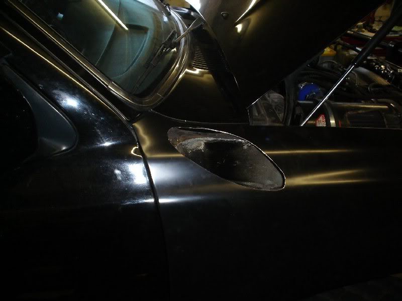

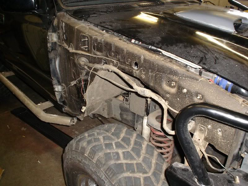

Als mounted the new fender and started on the snorkel. You can also see the scoop glued to the hood. Some filler, grinding and spraying and I'm done.
I used a piece of drain pipe (PVC) as a jig to mark the fender. Than I started Dremmeling (is that a word?) away.
And finally, my new fender:
Later

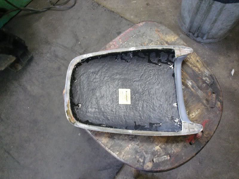

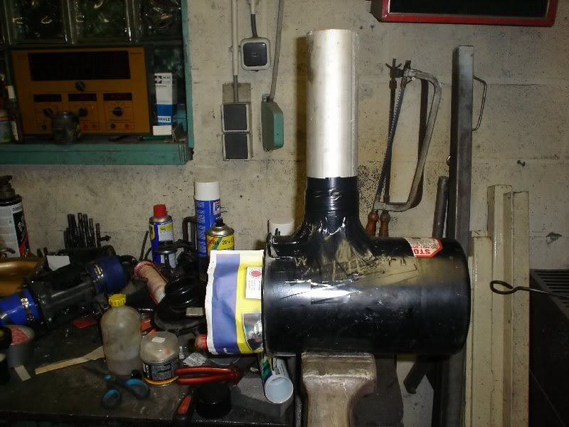

While that was drying I started on the airbox and the connection for the external sucktion tube.
I used a pice of pipe and lots of ducktape and PVC tape to make the mold:

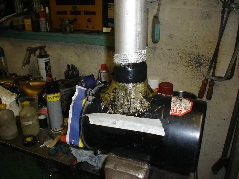

Put some glassfiber on and taped the piece where the hose will connect. Just to keep it in shape until it's dry.
Probably add a layer or two tomorrow.
Pic is kinda crap, looks better in reallife:

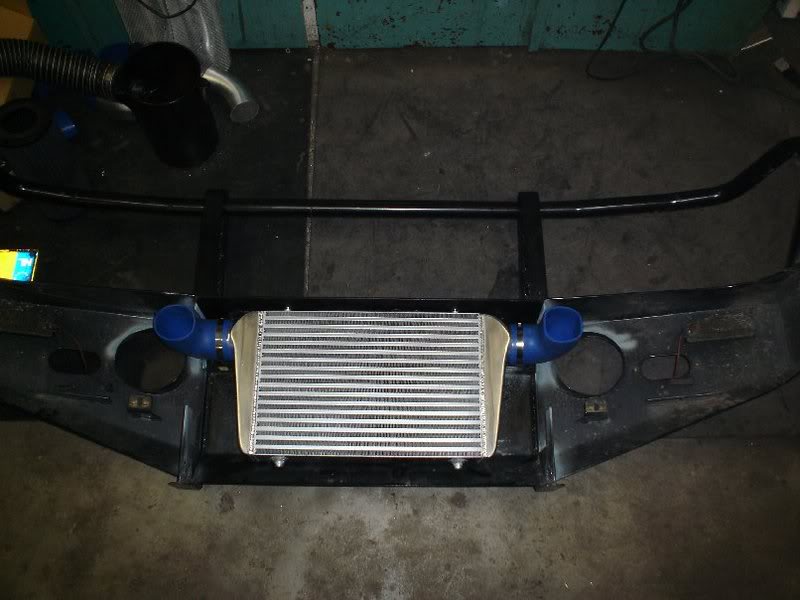

Got the mandrell bends yesterday so I started working on the new intercooler setup.
I finished the air box and rerouted some wiring, moved the fusebox etc. This to make room for the 3" piping which turned out to be HUGE. Luckily I have a 4" holesaw which I started with today. Chopped a piece out of the bumper and drilled 2 holes in the body.

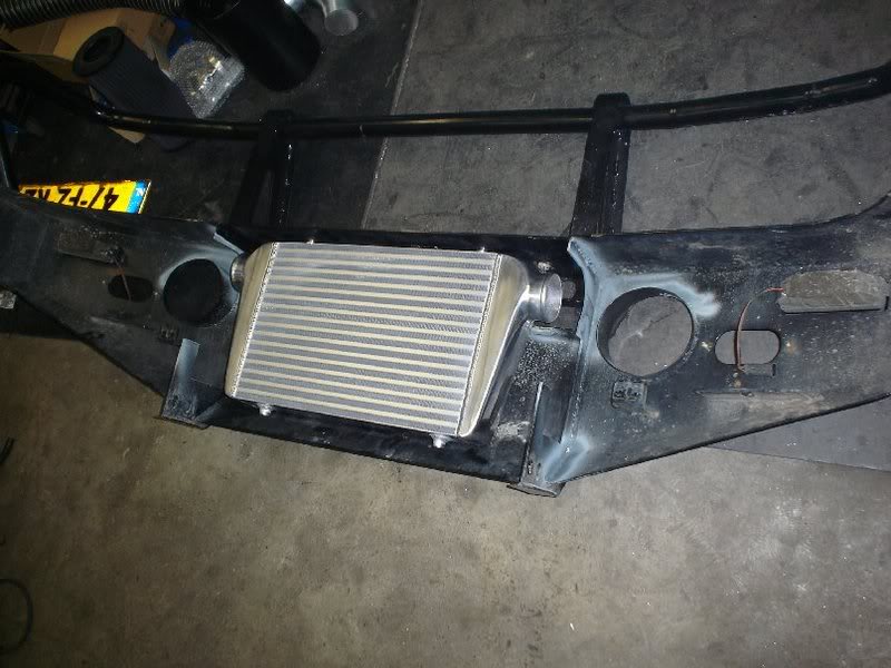

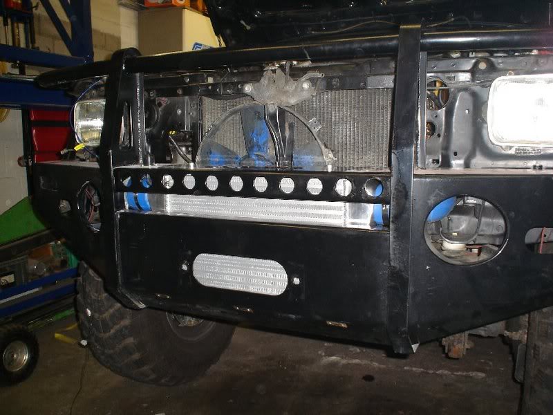

I fixed the intercooler to the bumper. Was the easiest thing to do, only 2 small brackets to make. I do have to disconnect the intercooler tubes in the future to remove the bumper.
This is the intercooler in its final resting space with 2 silicone 90 degree elbows attached.
Hooked up the turbo outlet with a silicone 90 degree bend and a reducer.
This is what it looks like without the grille.

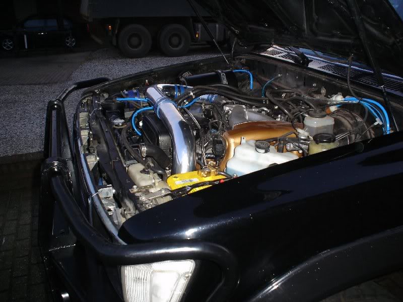

That's a good idea for later as soon the fuel problem is solved and I can open up the turbo.

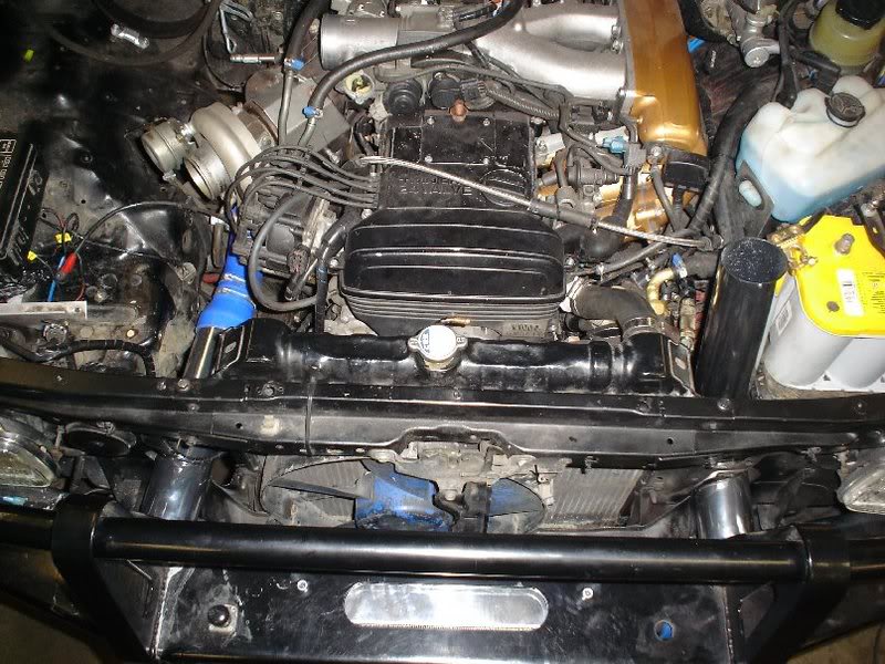

Did some testdriving and she responds much better now. Picks up easier cause she gets the air in much easier. Specially noticable at low rpms.
The turbo does only 0.3 bar cause the wastegate is still disconnected, but she still goes like a bat from hell. From 4500 rpm its a fast go to 6500-7000 rpm.
And she still is smooth and quit, even at high revs.
I did finish it quikly so my wife has transportation. That's why the hoses and wires are a mess and an abundance of zipties was used
This is how the inercooler piping looks like, I think this will be my final setup, except for the blowoff valve which I still need to hook up.

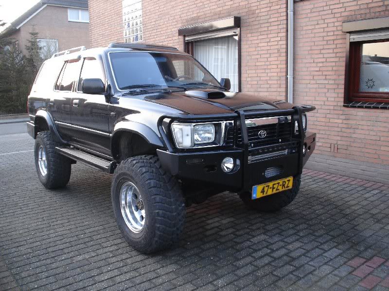

Front shot (I am really pleased with the look of the scoop):
And a side shot:
