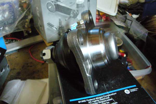

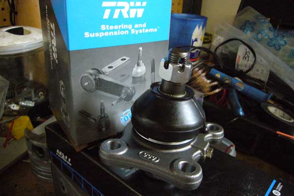

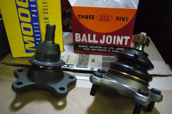

Here's some of the new front end parts going in. It doesn't matter what "box" you get at the parts store, you have to look inside to see what part you are getting. After hearing from YotaTech user Bear80 that the "555" front end parts were of higher quality than Moog, I had to check them out. For sure, they are nicer parts with wired on sealed boots vs. the press ons, some machined surfaces instead of cast: a nicer part than Moog. I have used Moog on a lot of other cars, but now that I have seen the 555 I'll be sticking with these. That said, the 2 upper ball joints that came from Rock Auto in Moog boxes, one was a Moog part, the other was a 555 part. I found 555 in the TRW boxes at Advance Auto Parts (which said they are moving to Moog now), and I also found the 555 parts in Sankei Boxes from another store. So you have to look inside.

Another shot of the lower ball joint, stamped "555" in the casting and from the TRW Federal Mogul box. It came with a grease fitting to screw in place of the bolt plug you see on the right side.

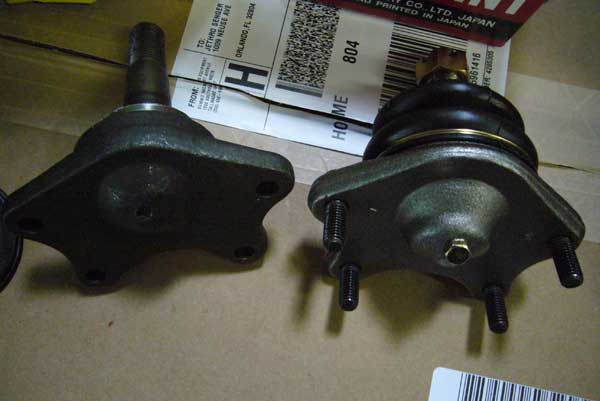

Here is the upper ball joint. You can see the difference in the casting. The studs in the 555 part were removed for installation of the SDORI spacers.

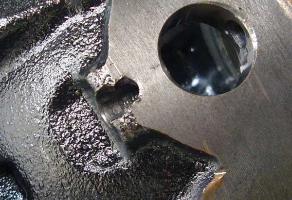

This would have probably held up for a while... but it was suspect. A few chunks of metal on the magnetic drain plug led me to it.
So I took it apart and found the pin broken inside. Swapped out carriers and all good now.

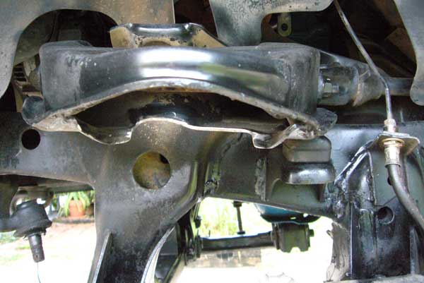

Upper A-arms trimmed for the 1.5" ball joint spacers
