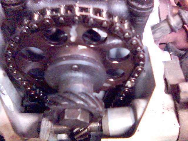

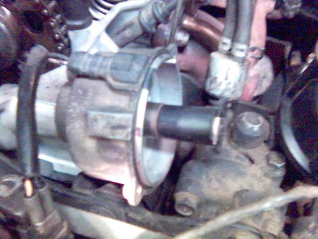

Its pretty much all back together besides a few vacuum lines, went to start it and wouldnt start. Made sure it had a good spark, and could smell fuel so pretty sure thats good. Messed with ignition timing alittle bit and got few back fires and figured it was ignition timing. Double checked cam and ignition timing and Im 99% sure its right on. Only thing else I can think of is if the injectors are hooked up in the wrong order, right now #1 cylinder has a white plug while the other 3 are blue. any ideas? thanks!

it may be 180 out on the dizzy. maby just a tooth or 2 off

I'm with subliminal. If you are getting back fires you are most likely 180* out. I speak from experience 2x's. It may look right but it's not. Also check the valve clearence. .08 in .12 ex, had that problem also, the valves were to tight and were not allowing full compression.

Im now sure cam timing is right on, I know piston #1 is at TDC and the cam is between the intake and exhuast lobes. I will check the valve clearence tonight.
