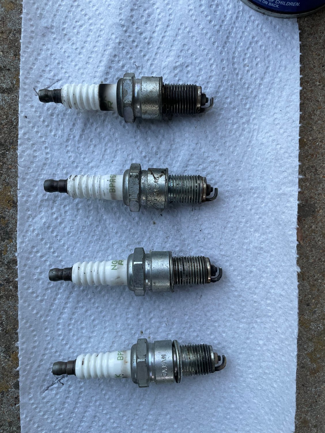

Here's what the plugs looked like in case that has any info.
