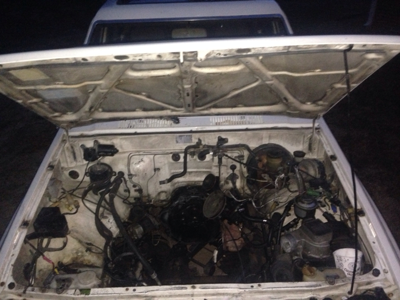

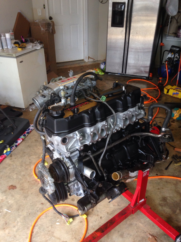

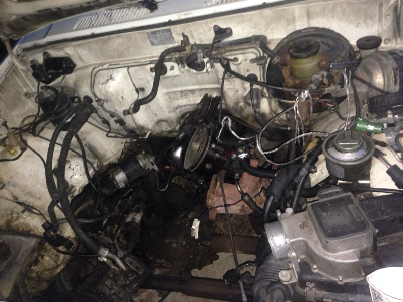

Well I have done it again. Just pulled the blown engine from the 4runner. Luck may have it. The engine I bought for $150 buck is completely stock and getting bored 20 over crank is being ground and line bored due to a spun bearing. Hope to get my hands on it tomorrow. But some progress on pullin the engine. So I got to start somewhere. I did find a wiring harness from an 1987 4runner hope that works out as well. I also bought a new head from engine builder with 261 cam and full rebuild kit ,oil pump and water pump. So hopefully I will get it all back together in next few weeks. I may also paint the engine bay if I can get the time. Looks kinda bad compared to the rest of the runner. So that's bout it. Any suggestion would be great Thanks in advance

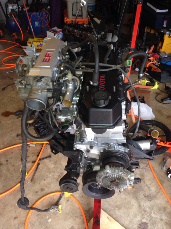

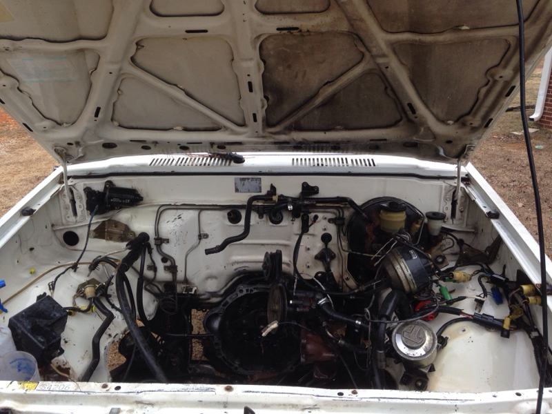

Well started cleaning the engine bay. It was pretty nasty to say the least. Got most of it do before the fam got home. You can see the difference in the hood. Nothing like a lil elbow grease.
So I'm on my way. Also ordered new headers from LCE and the head light conversion kit. So I will let u know how those go. Slowly but surely on my way.

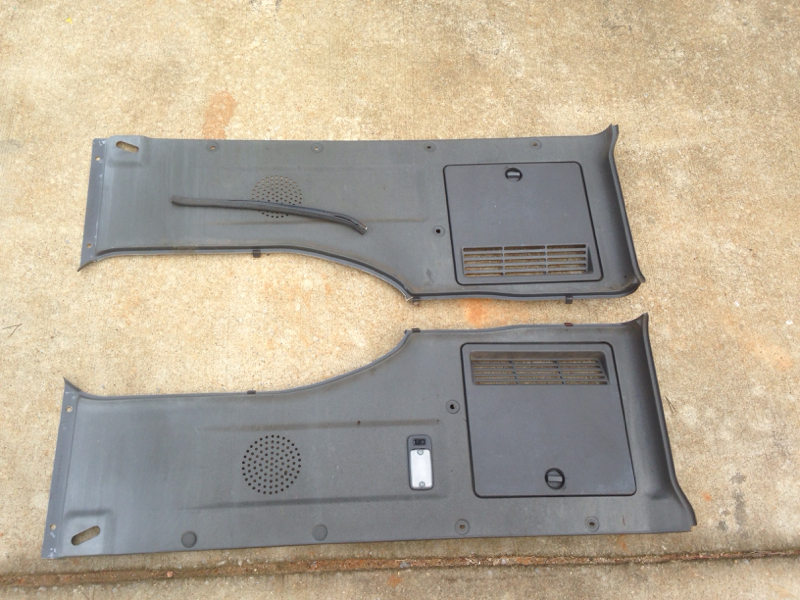

Look what I found at a local junk yard all in one piece.

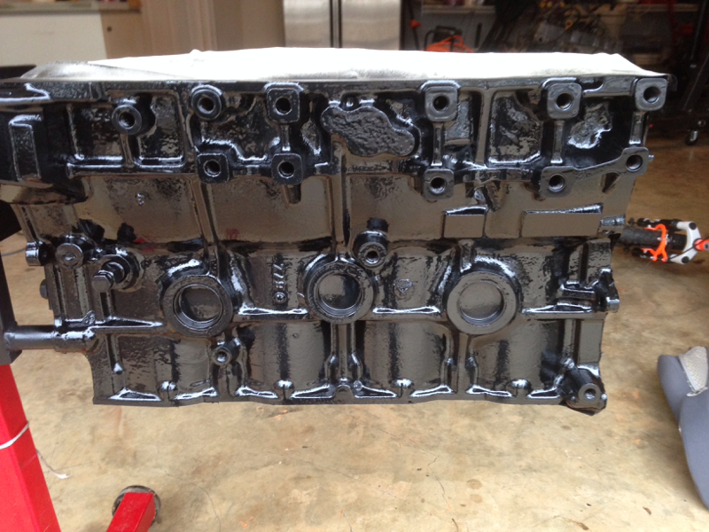

Well thanks to engine builder got the new ring in. Got the final piston in and went to town today on the engine assembling everything. Just have to pull the oil pan off the old engine and clean it up and paint it. And put it on and the engine should be ready to go back in the truck. As far as the wiring looks to be one extra wire so not sure what it does but everything seems to match up so far.
