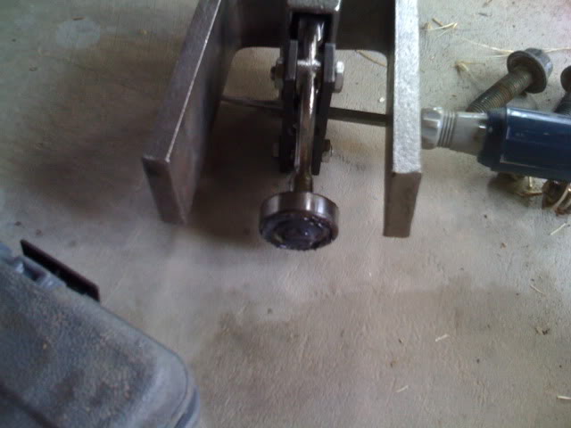

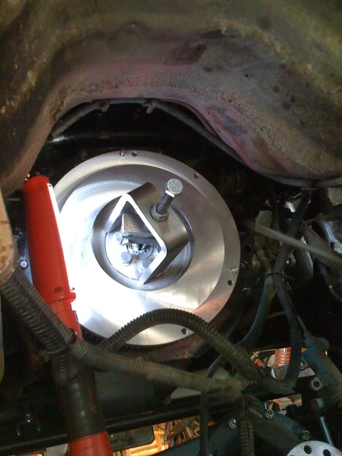

I did mine last week (clutch) Getting the bearing out was a PITA
I think this is the tool you are looking for. The ole "grease pressure thingy" never worked for me. I borrowed this one from a shop.
