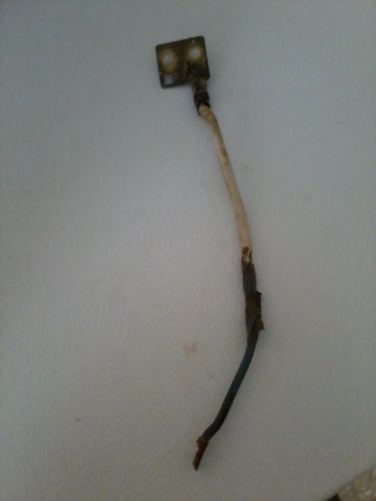

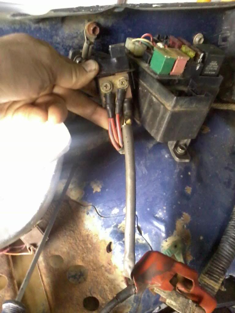

Your Fusible Link is from the positive side of the battery cable to the fuse box.
Some other information if you want to look further into the fusible link.... https://www.yotatech.com/forums/f199...l#post51747852

i checked the fusible link. although it doesnt appear to be factory toyota, it doesn't appear to be damaged. i also have power to accessories when i turn the key which according to the link provided, would rule out the fusible link.

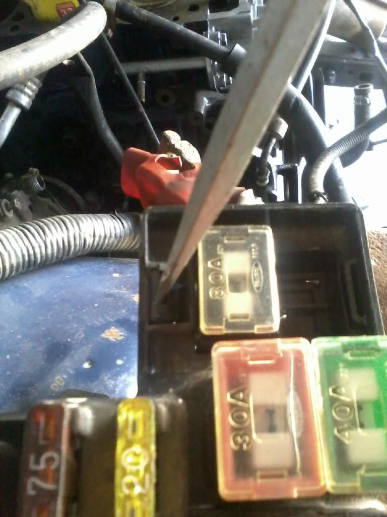

After reading your thread again, seems like I had a similar situation where some things worked but not others. How is the 80 amp fuse that connects to the fusible link.
All of the other fuses lift up and out. The 80 Amp you have to pry this tab to the firewall and push out the bottom.
Here it is mounted to the Fuse. It mounts behind the wires. I usually have to take a 8mm socket to the screws the first time. They can be TIGHT.
The 80 amp fuse was checked.
