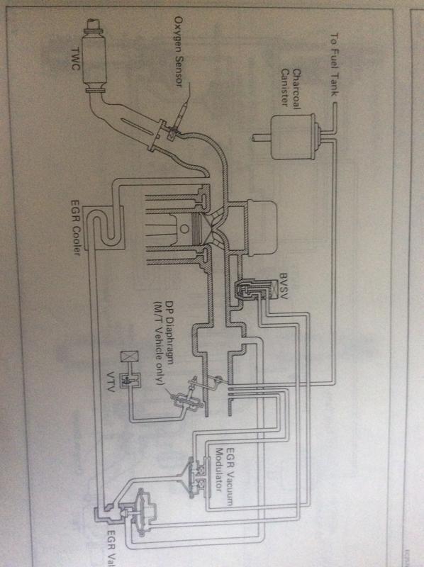

your o2 sensor should not be under the seat, or near under the seat in an '87. the o2 sensor is located on the exhaust manifold, and the connector is right there in the engine bay at the driver side fender. you unplugged the seatbelt indicator.
i doubt your egr is playing any role in your hard starts, although it might play a role in the warm engine miss. you can follow the FSM directions to troubleshoot the egr and its associated vacuum switching to determine whether it is functional.

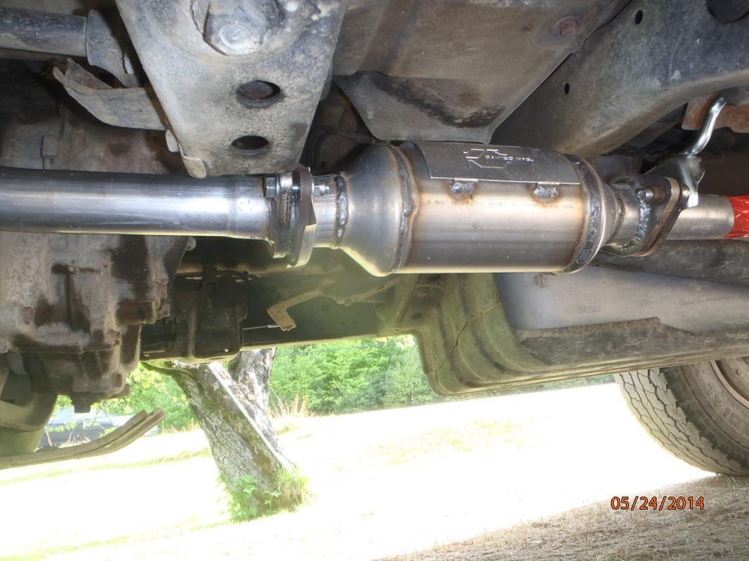

That's peculiar, as my 02 sensor is FOR SURE under my drivers seat. I followed the line up and disconnected it previously, but will baseline this again in a little while.

Also, my manifold does not have any sort of 02 bung.

you have a modified system. for '87 model year 22re 4runners, the o2 is attached to the manifold, with the connector exactly where i stated. this could certainly play a role in the symptoms you have; who knows whether it was modified correctly?
