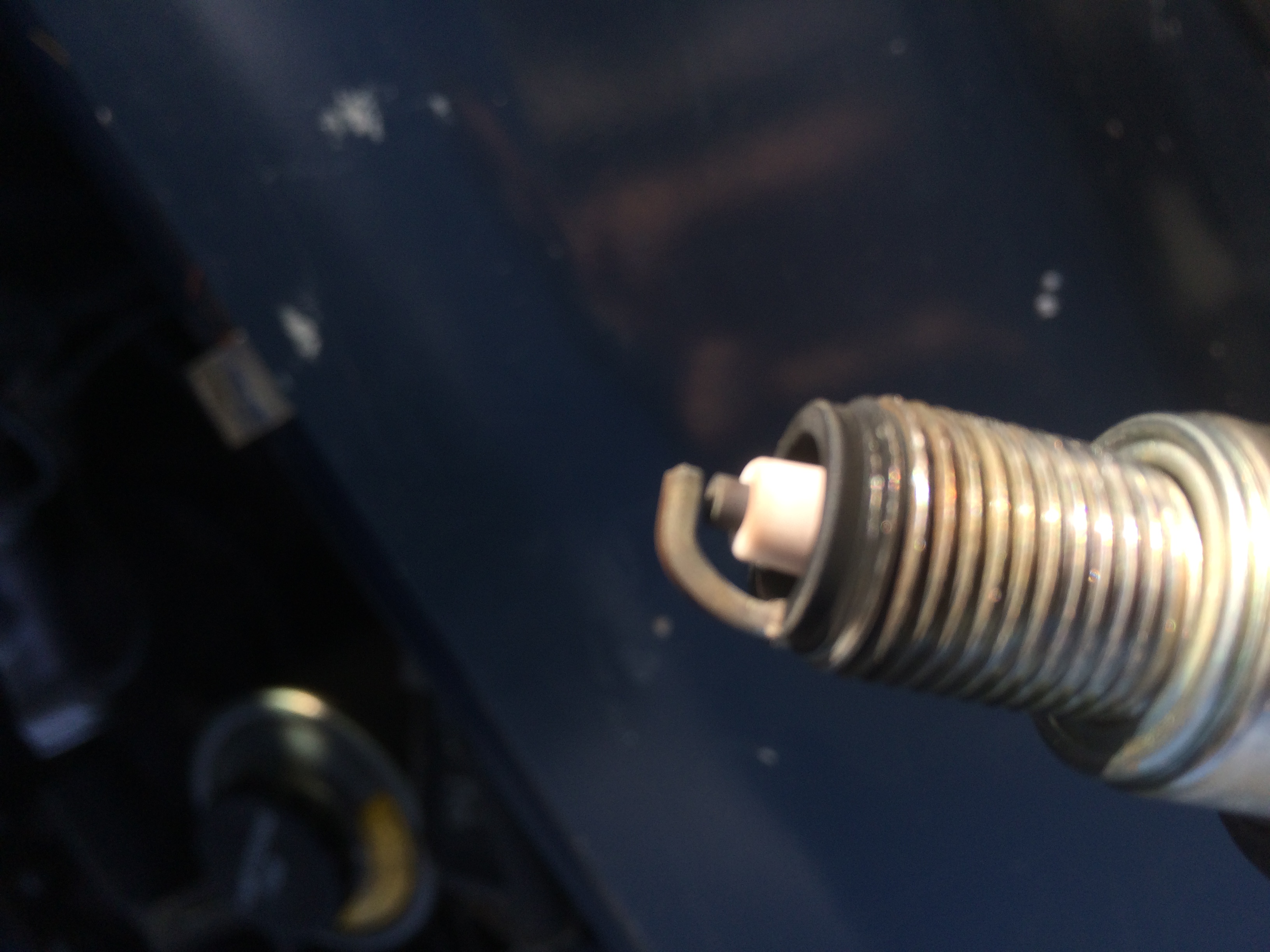

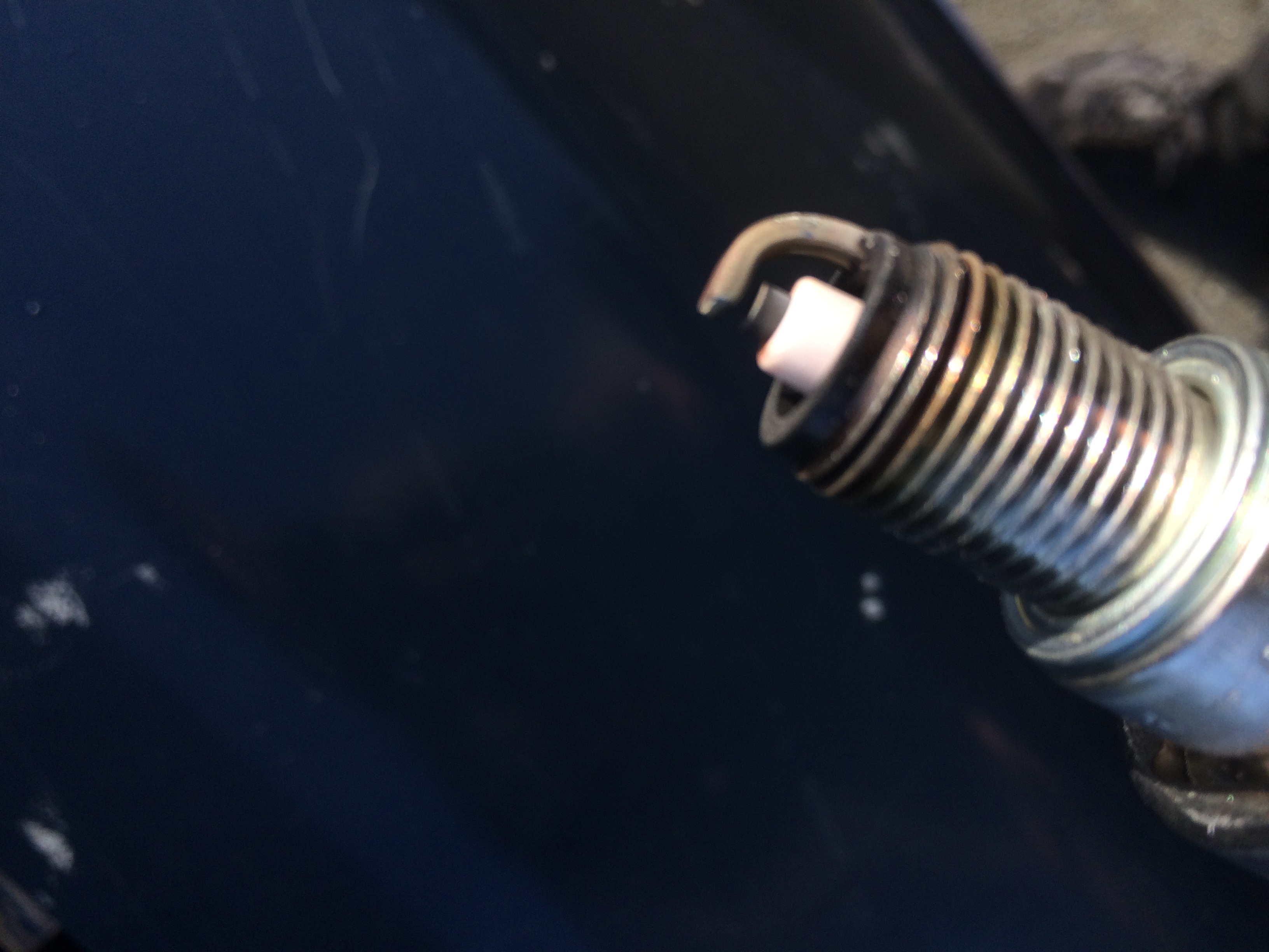

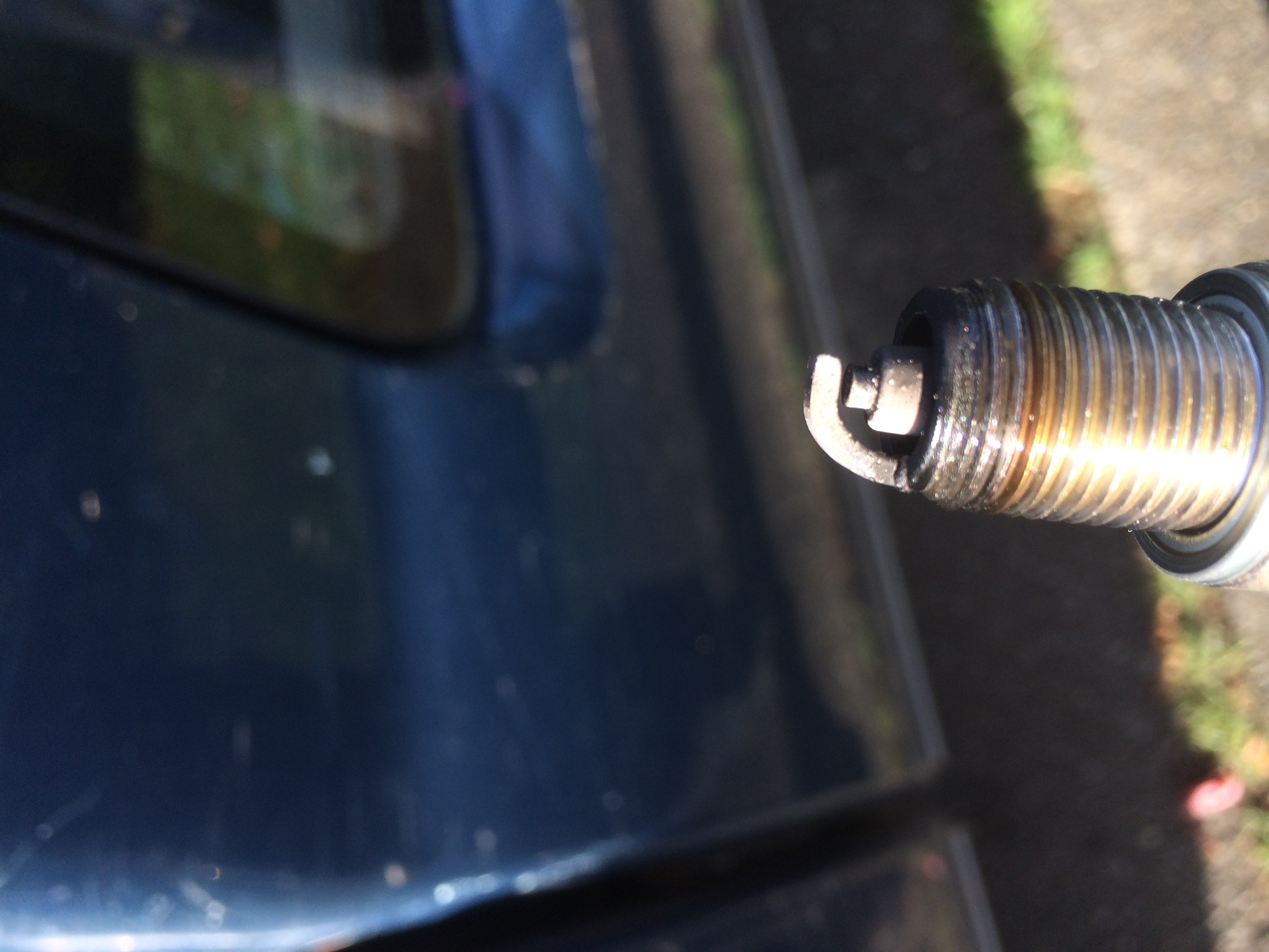

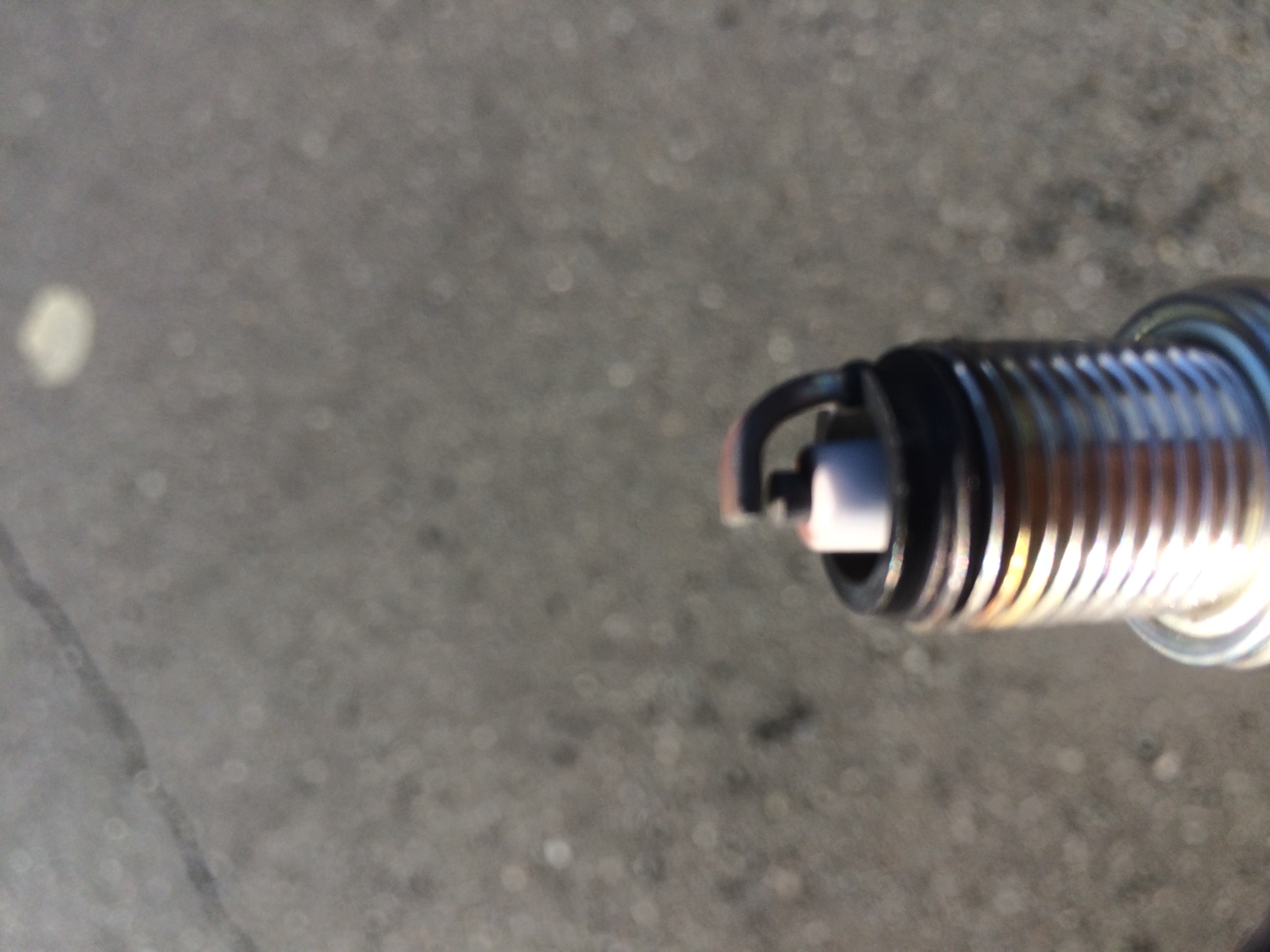

Attached some pics of the spark plugs. #1 looks a bit fouled but not sure of its normal while rings are seating to have some of that. There was a bit of oil in the well too.. .. smoke seems reduced but definitely stil present. Could be warmer weather it's been real nice up here (Denman island British Columbia)

Definitely looks like number 1 is the culprit. Id say that is not normal for new. Possibly a bad valve seal or guide as mentioned previously. What kind of warranty did they give you?
