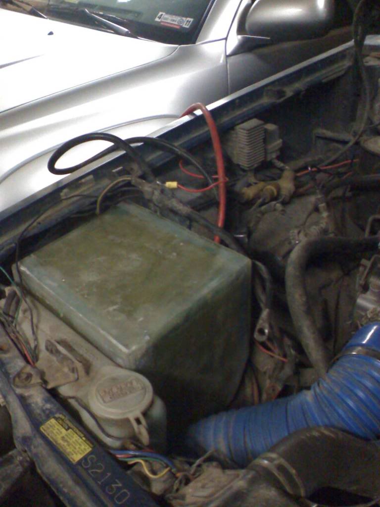

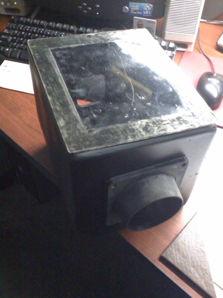

Well, you could put something together like that or completely fab something up. Either a complete box or just a two sided heat shield.

I'd make something like this, because this is what I'm recommending to another Supra mod user and is what I would do. If you don't plan on blasting thru water and mud a full box isn't necessary.
You could always just do this:
