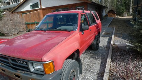

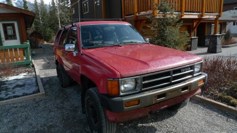

As requested, here are some pictures of the latest edition to the family (My FJ got a little brother)....lol
