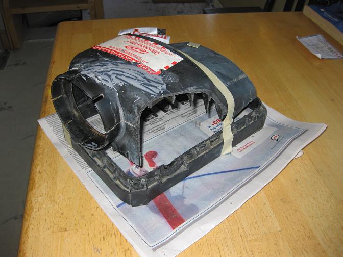

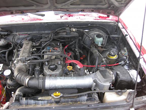

Finally had the time to complete this small job. Consists of the 1982 plug and play AFM, Caprice LT1 air cleaner top, spare 22RE top- grafted them together...not pretty used a ton of fiberglass to beef the casing up. Just have to figure out the intake ducting, thinking of 3in ss. Too slippery to get on the juice- but at least it runs good.

Gotta love duct tape
