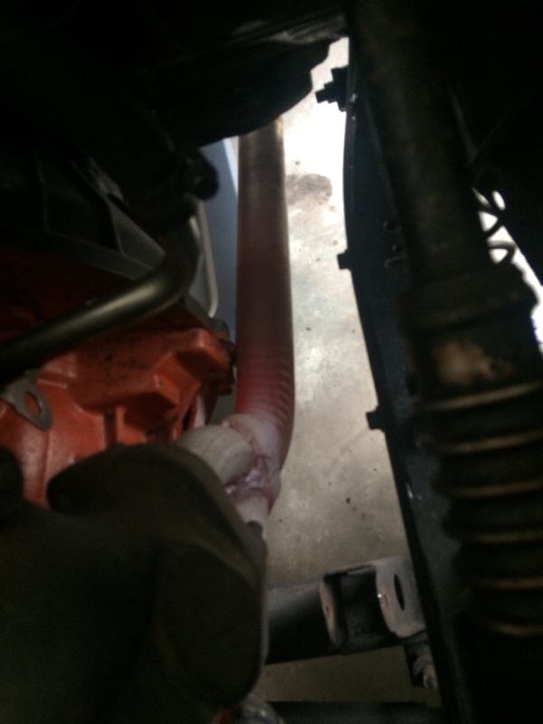

I have a 1994 pickup 22re motor has been refreshed new head gasket,timing chain, all gaskets etc. when I start it has very little throttle response and the down pipe gets extremely hot and glows red after about 10 seconds after running.does anyone know what this could be and how to fix it?

Catalytic converter is plugged up creating a restriction.
Or your running super lean, but the O2 sensor will correct the fuel trims to correct that, if good.

i'm thinking that it's gotta be: 1)retarded timing 2)super lean 3)plugged exhaust 4)tight valve allowing burning gas into the exhaust.
does the cat have a front flange, that can be disconnected? run it open pipe, see if it heats up.
pull the plug(s), see if they are white from being lean.
i would adjust the valves again, and check the static timing at that point.

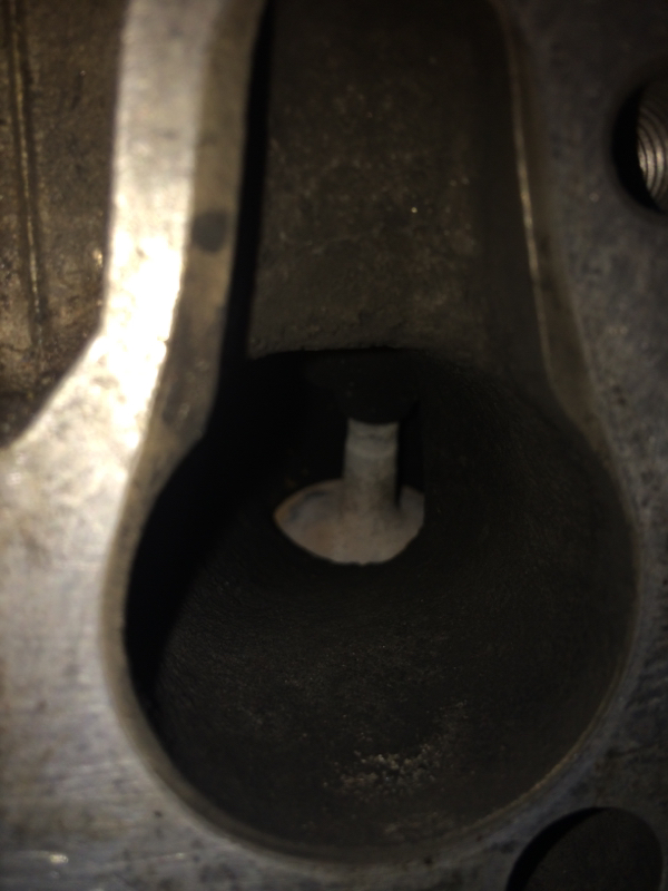

Think I found the problem the cam shaft caps where on there so tight I couldnt move it by hand with the rocket assembly and chain off. The valves are nice and white,

The valves are white because you're letting still-burning mixture out the exhaust valve. My guess is timing, which is pretty easy to check. Check not only for static timing after jumping, but make sure it advances (unjumpered) when revving the motor. My guess is that it's not advancing much.
The valves have now croaked - sounds like you've now got bad bearings or bad bearing surfaces, maybe both.
