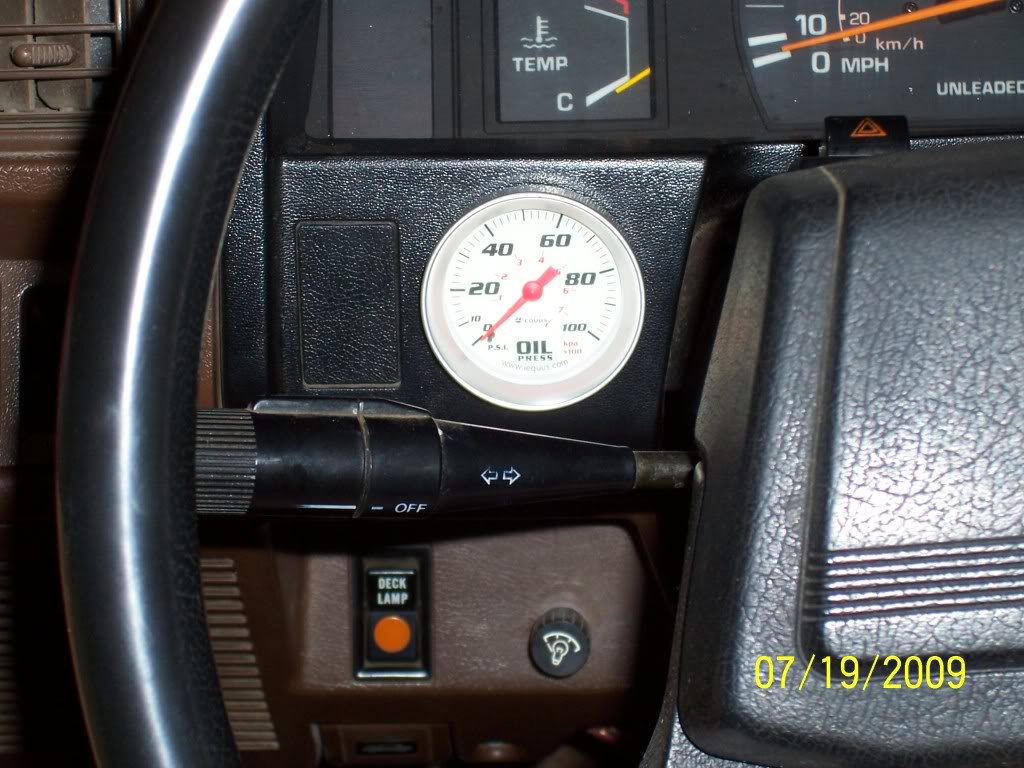

Are you guys running oil pressure gauges?

Yes to the oil pressure gauge. This one was $25.
I'm definetly glad I put in a new radiator. At least have yours tested.
