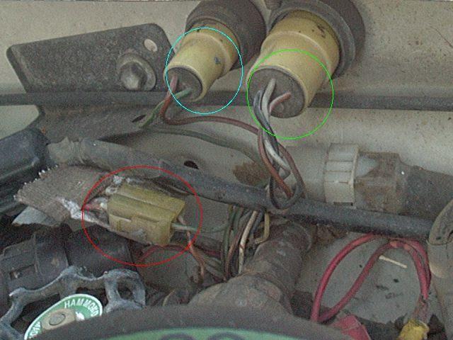

Saw a very well written response to a post on installing a broadband O2 sensor and A/F meter a while back. In which the responder mentioned Measuring the voltage reading to ECU from O2 sensor. The FSM says use SST 09842-14010 to do so.
So my question is does anyone have the pin out of the service connector? The one circled in green.
*** thank you 4crawler for the posted image.
Thanks,
Scott

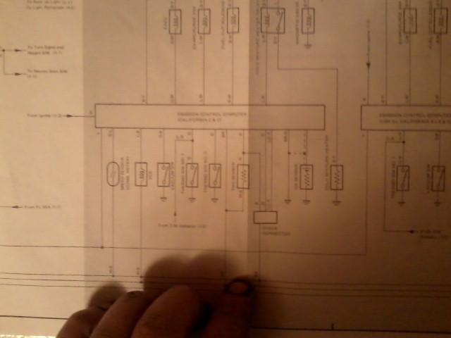

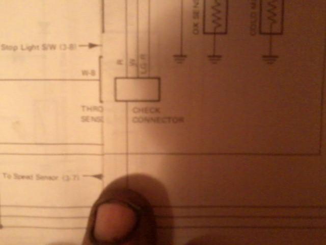

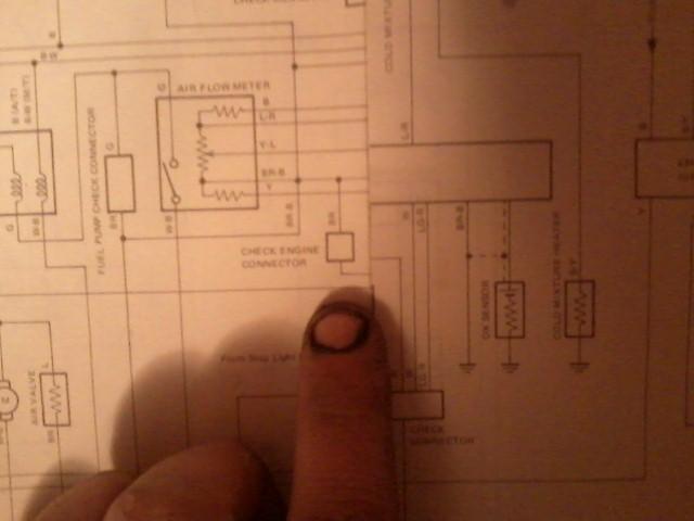

Those are 85/86 connecotrs. I have an 85 FSM. I am blind as a bat but can you see the color code on this? I cant find my wifes glasses and I am still in denial of my eyesight.
This one is BR
This one is Left to right R,W, LG-R I think this one is the Green Circle.

I am not finding the "Service" connector in the FSM. Is that what it is called?

Someone liberated my hard copy of the FSM. But the my digital reference to the connect is FI-69 of the 85 FSM.
I apologize but looking through the wiring schematics on the digital copy is difficult and I didn't think of it till you post. But page 1 to 4 under EFI says test connector. Though it looks like only 2 leads coming off of it instead of the three physical wires at connector.
I'm I looking at the correct connector?
