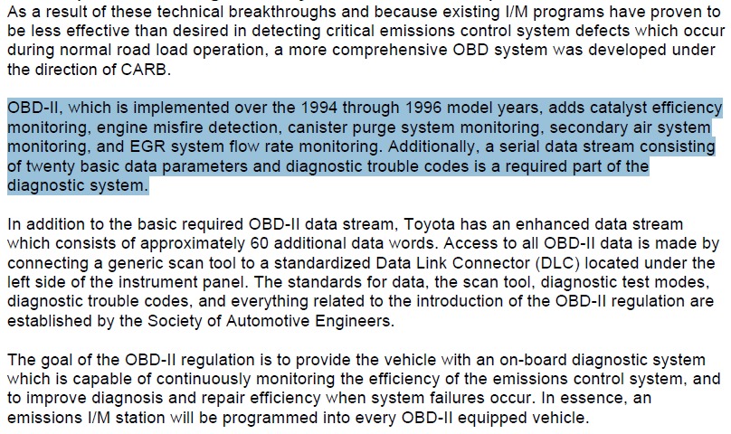

Originally Posted by abecedarian
Toyota's VAST from what, 85-94 is not OBD I.
It most certainly is.
Not that it matters, because all 85-95 EFI trucks & 4Runners use ESA instead of VAST.
Sounds like you need to read up on Toyota OBDI EFI/TCCS Ignition Systems* and Toyota OBDI and OBDII system definitions.
*The 22R-E(C) and 22R-TE do actually use ESA(as can be verified in the 85, 88, & 93 FSMs), not VAST as is stated in this pdf. Though both ESA and VAST were used in OBDI EFI/TCCS systems(just not those found in trucks & 4Runners).
And here's another quick tip: If you can't plug an OBDII scan tool into it...IT'S NOT OBDII!!!
Who's laughing now?
