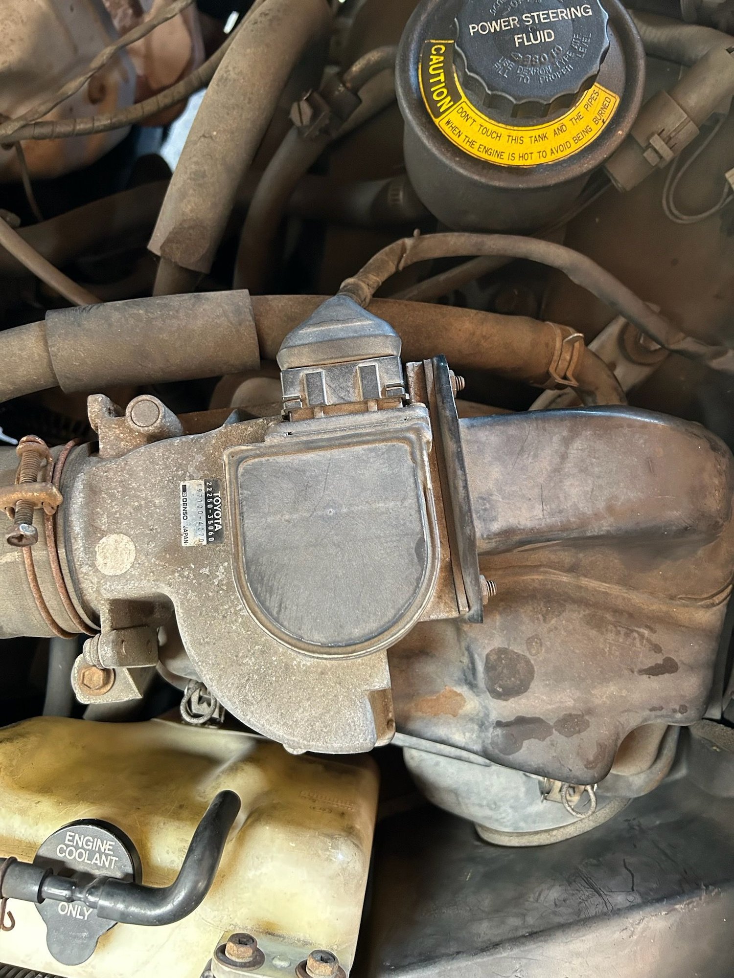

I have an '89 4Runner that sounds like it is having the same issue. (sorry about the size of the image, I don't know how to make it small)
A replacement was found but it was worse off than mine. Searching around I can find the 35050 but the 35060 is pretty much non-existent. Can the other be used? Mine is the 22RE, not the 3VZE
This is the picture from my engine

I'd need a model number and production date to confirm, but if yours is a 1989 22RE then 35050 would be the correct one.
From the few model # I checked, 35050 covered 1989-1995 for the 22RE

My mechanic verified with Toyota that the 35060 is the proper part

Ah, ok. If your Vehicle was built 8/88-3/89 then yes, 35060 is correct. From 4/89-01/95 then 35050 would be the right one.

Ok so curiosity and insomnia got me last night... after lots of searching the online parts catalog this is what I determined.
22250-35060 (8/88 - 3/89) is for 22REC (CA emissions)
22250-36050 (8/88 - 11/95) is for 22RE (non CA emissions)
22REC from 8/83 - 8/88 used 22250-35020. If njbradjr is in CA (or pass smog in general) then maybe you can use that part # as a replacement. Here's one on ebay.
https://www.ebay.com/itm/18634003316...YaAmLYEALw_wcB
Another interesting point is as far back as 85 (as far as I looked), if you have EFI then you're a 22REC. Look for yourself if you're not convinced.
