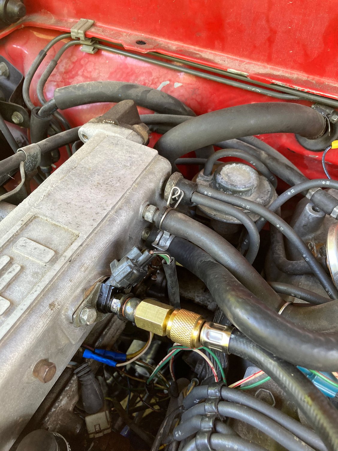

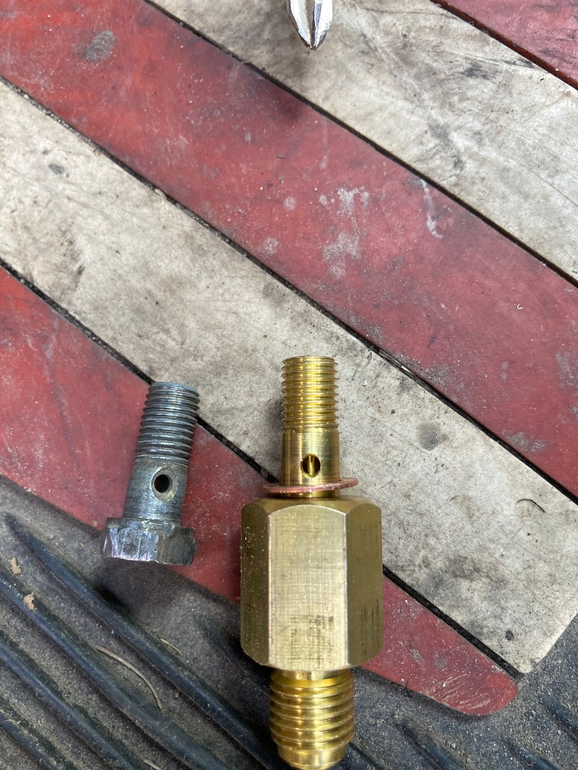

Old Jul 15, 2020 | 10:42 AM
sipe33's Avatar
Joined: Feb 2015
Posts: 12
On the right is the pressure tester banjo bolt.
If you flip over the banjo bolts to the other side. You can see that the hole does not go the whole way through.
Pressure testing right here in the CSI.

Right. That's exactly the correct item for this application.
Run the tester's bolt through the circular fitting on the fuel pipe, and into the CSI, just like you would with the normal bolt. Imagine the large, hexagonal, area is the top of the bolt, where you would put the wrench on it to tighten it down. Remember to put the crush washers on, and to only torque it to the proper spec.
Then screw the actual gauge down onto the top, tapered portion of the bolt. A lot of people, I think, use teflon tape to help seal the gauge down. I swear I've seen that on other threads in here. Remember to turn it so it's visible! You don't want to get done snugging it into place, only to find out it's facing straight to the bottom of the engine or something.

Okay hooked it up.
This is the reading that got. Seems low, is that low enoough to not keep truck running for more than a couple seconds. This reading is with the fuel pump jumped in the diagnostic box. Thank you.
Back to front here.
You can see the annular ring in the banjo (fuel side) of the fuel line has a clearance? This lets the fuel flow out the hole in the fuel line and into the bolt regardless of the relation of the holes being lined up.
In the other two photos you can see the taper of the bolt and guage adapter, these should thread into the CSI in the same orientation ( head/guage to the "outside")
