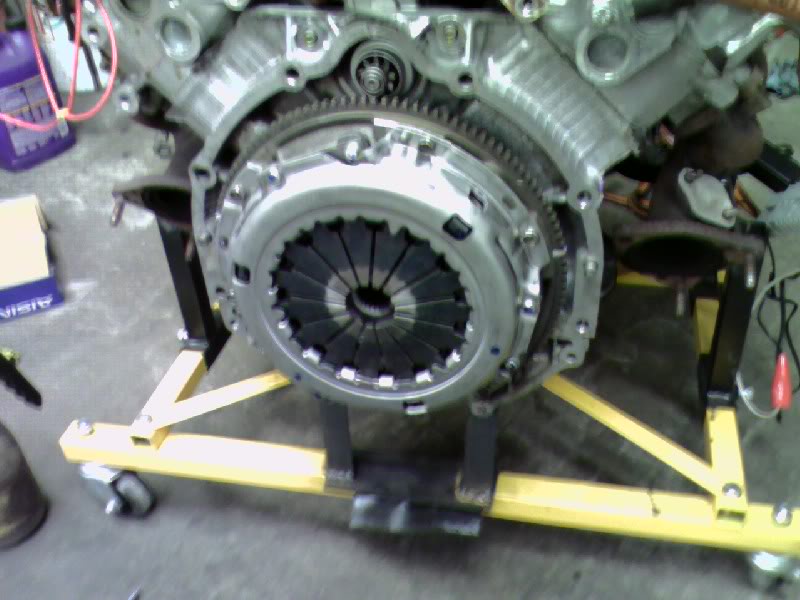

I have a 3SGTE ( 2nd gen MR2 turbo)flywheel behind my 1UZFE. They both have the same number of mounting holes, but the 1UZFE uses a larger radius. I had a machinist plug the original crank mounting holes and then redrill the 1UZFE pattern. The only other mod needed is to file a chamfer on the ring gear teeth since the 1UZFE starter is mounted on the engine side compared to the trans side on th 3SGTE. The 3.0l clutch bolts on with no mods.

Only pic I have of the flywheel is after the clutch was installed.
