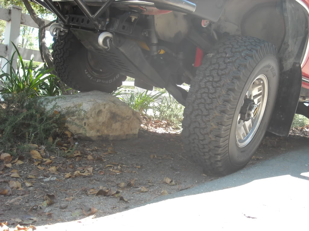

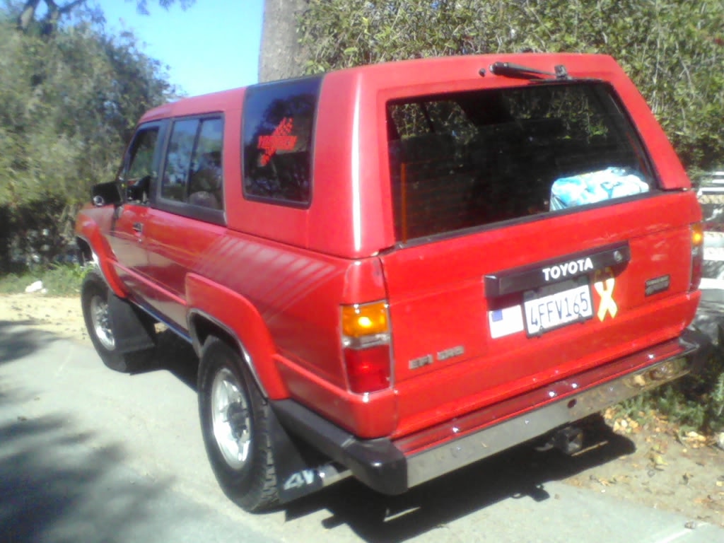

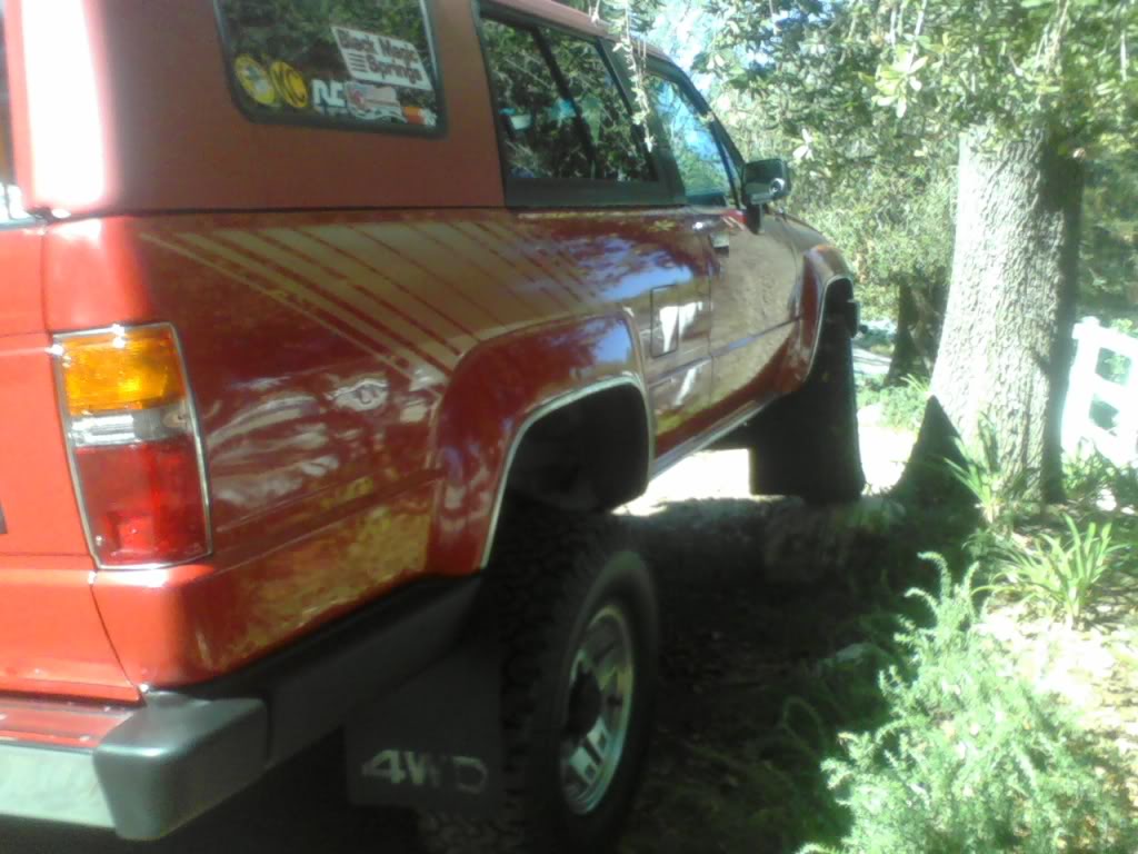

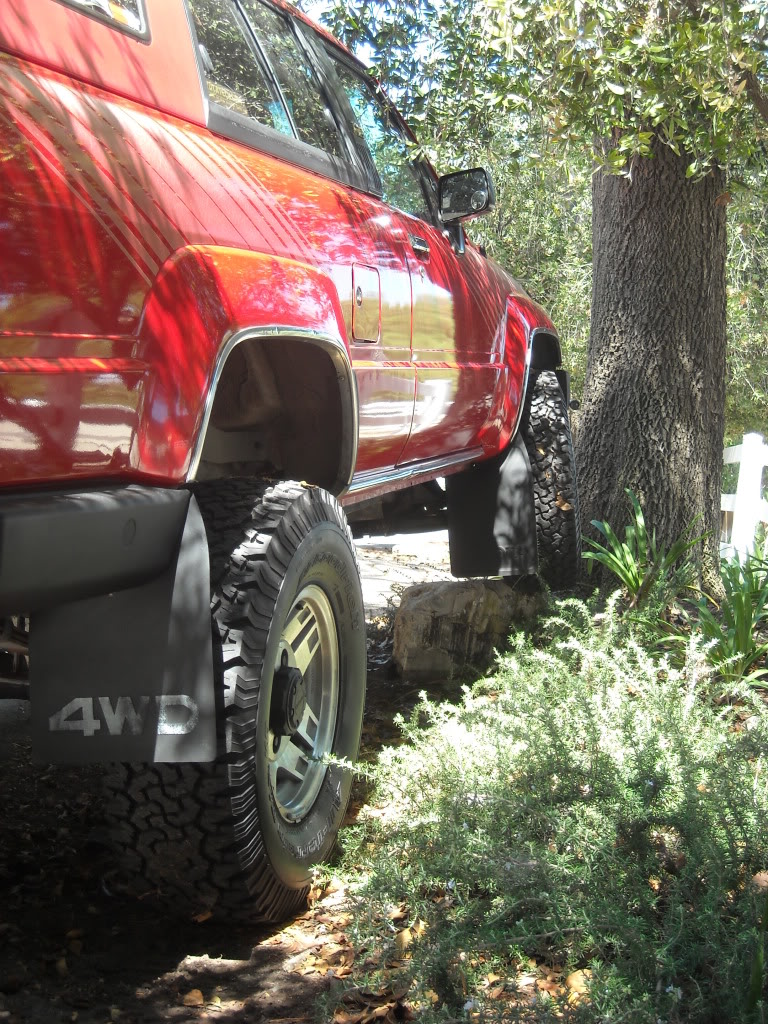

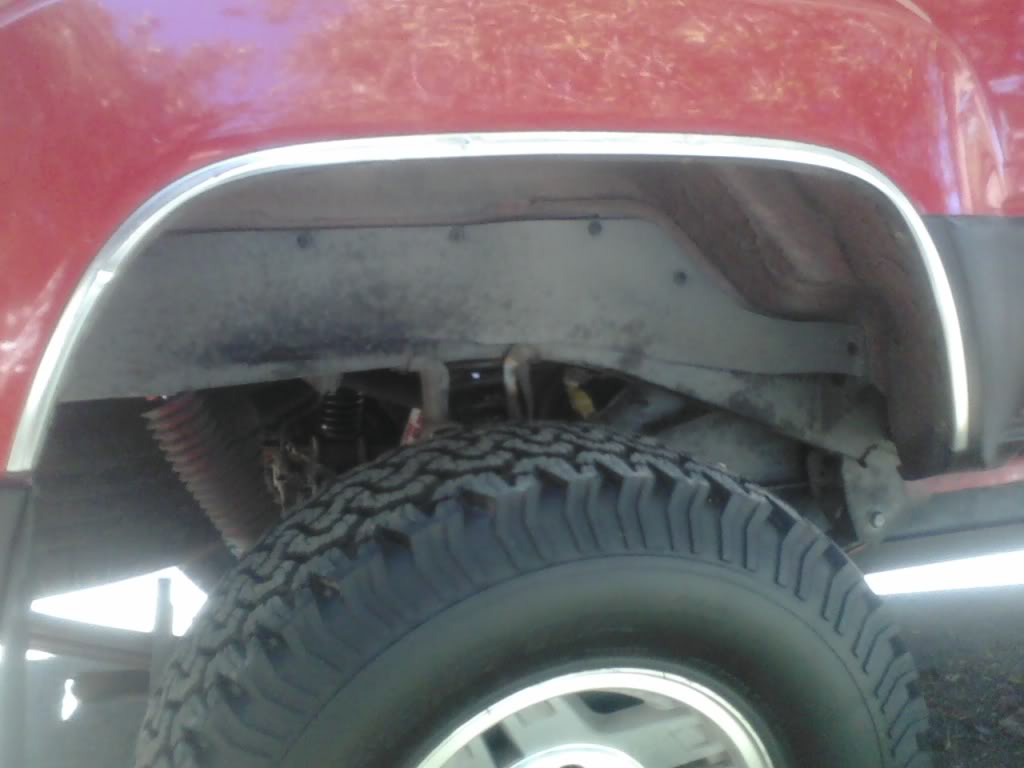

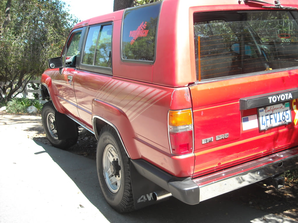

Got some better ones, Phil, lol...... LIL less blurry, lol.......
They (12" x 125#) flex 'OK' for me.
